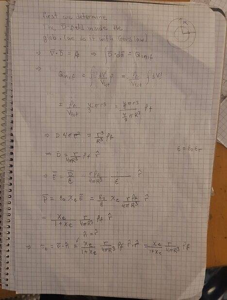

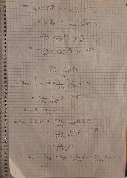

A sphere with radius R and the dielectric constant χ_e has been charged with a uniform free
space charge density with the value ρ_f (e.g by being bombarded with α-particles which,
after being braked to rest, can no longer move).
b)Now suppose that the free charge distribution is not completely immobile, but that we can
have currents of free charge described by Ohm's law with the conductivity ## \sigma_{\alpha}## At t = 0
we imagine that, as in a), the free space charge density is ρ_f everywhere in the globe.
Determine how the free charge density in the globe varies in space and time for t> 0.
## \vec \nabla \cdot \vec J = - \frac{\partial \rho }{\partial t} ##
## \vec J = \sigma_{\alpha} \vec E ##
Hello, I wonder if you could give me some advice to how solve this question. What I was thinking to solve it was to determine J by using Ohms law, ## \vec J = \sigma_{\alpha} \vec E ## I already determined the E field for for the sphere, I got it from a) ("a)" was to determined all the bound charges and show that the sum of them is zero, I attached the solution) If you see there I solve the electric field by Using ## \vec D = \epsilon E ## where i I got ## \vec D## from gauss law for a gaussiuan sphere with radius r< R (inside the sphere) and got that the eletric field of this gaussian sphere is $$ \vec E = \frac{r \rho_f}{4\pi R^3}\frac{1}{\epsilon_0 \left ( 1+ X_e \right ) } \hat r$$. But I wonder if in this case( b) will r = R? or how can I proceed?
Edit: I realized that the field was incorrect, I re-wrote it and got $$ \vec E = \frac{1}{3}\frac{\rho_f r}{\epsilon_0 (1+X_e)} $$
Ok, that looks good. But you should include a unit vector to indicate the direction of ##\vec E##.
Instead of going to the trouble of finding the polarization ##\vec P## and the bound charge density, see if you can determine the time dependence of the free charge density from this expression for ##\vec E## and the two equations that you wrote for the "Relevant Equations".
I reread the original problem statement and it says that ##\chi_e## is the dielectric constant, not the susceptibility. Your expression for ##E## would be correct if ##\chi_e## is the susceptibility. So, you need to modify it
oh yes, I will fix that. What I'm stuck with is that the divergens of ##\vec J## because the field I determined is the field inside the sphere, so I don't know if I should change r to R. But if I do that the divergens will be zero because the R is constant. so I don't know if I should keep the r and derivate or what can I do?
You want to investigate how ##\rho_f## changes with time for any point inside the sphere. So, you want to leave ##r## as a variable in the expression for ##\vec J##. Then ##\vec \nabla \cdot \vec J## at some point inside the sphere will give you the negative of the rate of change of ##\rho_f## at that point.
