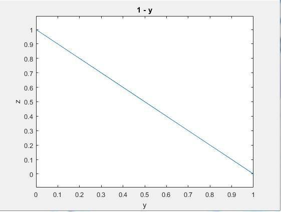

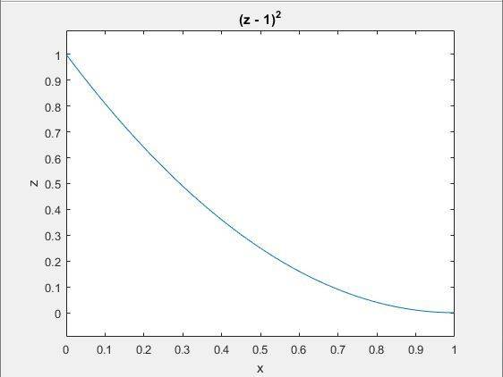

EDIT: The shape is simple (as in x-, y- and z-simple) in all 3 dimensions, so I was able to print out the projections to the different coordinate planes:
y(x):
z(y)
x(z):
After thinking about this for a bit I think this might be the correct answer for the case ##dy dx dz##:
[tex] \int_0^1 \int_{0}^{(1-z)^2} \int_{\sqrt{x}}^{1} f(x,y,z) dy dx dz[/tex]
I'm saying this, because
\begin{cases}
y = \sqrt{x} \iff x = y^2\\
y+z = 1 \iff z = 1- \sqrt{x} \iff x = (1-z)^2
\end{cases}
How does this look?
Using the same logic as above for two other cases:
##dxdydz##:
[tex]\int_{0}^{1} \int_{0}^{1-z} \int_{0}^{y^2}f(x,y,z) dxdydz[/tex]
and ##dzdxdy##:
[tex]\int_{0}^{1} \int_{0}^{y^2} \int_{0}^{1-y} f(x,y,z) dzdxdy[/tex]
