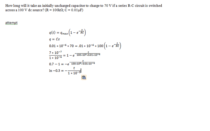

The discussion focuses on the process of solving capacitor charging time equations, specifically addressing the equation 0.7 - 1 = -e^t. The user struggles with logarithmic calculations, particularly with ln(-0.3), which is not defined. The conversation confirms that the procedure followed is correct, and the user seeks clarification on discrepancies in answers from previous problems.
