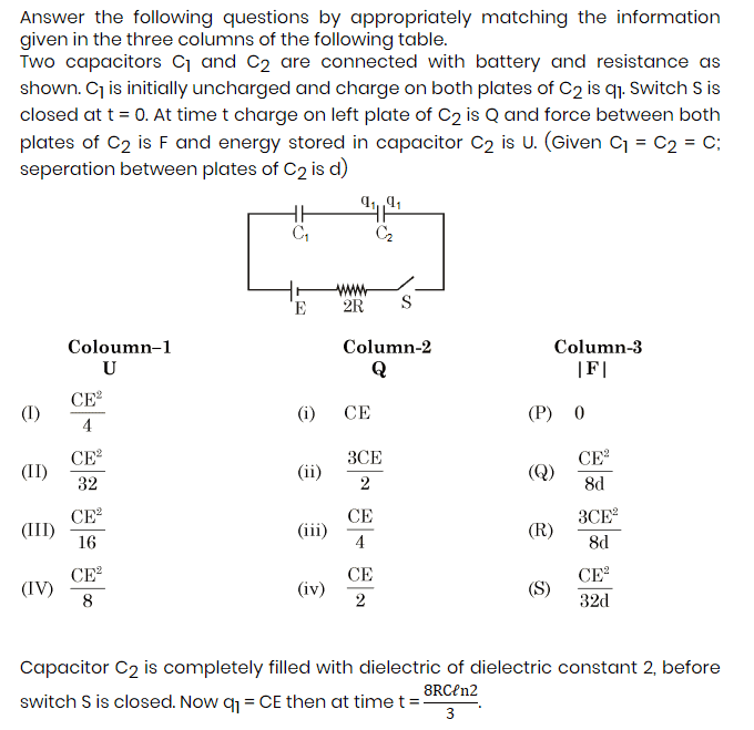

I attached the question in the attachments.
Q=CV; Kirchoff's law of voltage
Well i don't you to solve the question for me but I want you to clarify the concepts pertaining to this question. My question is how do I write a equation for the circuit since the there is same charge on one of the capacitors. While writing the equation should i put the voltage across the charged capacitor as (q+q1)/C2 or (q-q1)/c2? Or what should i do? What is the concept? if there is a way by which the time constant can be calculated and be used to our advantage in computing the charge on the capacitors?

This question is ill-formulated in my opinion. Specifically, I don't know how to process the statement "C1 is initially uncharged and charge on both plates of C2 is q1." The conductor connecting the two capacitors is an equipotential. One cannot have q1 on the left plate of C2 and zero charge on the right plate of C1. Also this statement seems to assert that each plate of C2 carries charge of the same magnitude and sign.
Maybe the author's intent is that capacitor C2 is separately charged by a battery to charge q1 and then connected to capacitor C1 while the switch open as all this is going on. That's far removed from the posted description.

OK, I'm not sure I can help with the answer, I haven't thought that hard about it. But I can give you some of my impressions:
1) The charge on both sides of C2 is q1. This means that there is no voltage or energy in/across C1.
2) Because C1 is connected to C2 the charge on the right side of C1 MUST be q1 also. According to the schematic they are they same thing. The right side of C1 IS the left side of C2.
3) Because they said "C1 is initially uncharged", then there must be no charge difference across C1. So the charge on the left side if C1 is also q1.
4) OK, now let's recall some basic capacitor stuff: Δq=CV, so if Δq=0 => V=0 across each capacitor. Since you have 2 capacitors each with 0 voltage across them, you can combine them into 1 equivalent capacitor, let's call it C3=C1*C2/(C1+C2)=C/2. C3 also has 0 volts across it. This last step isn't necessary, I would just rather deal with one capacitor than 2.
5) So, to summarize so far: we have a circuit with C3 (=C/2), E, and R all in series with an open switch and there is no initial voltage across C3 (or C1 and C2, if you prefer).
7) When the switch is closed you will have current flowing, limited by R, to charge the capacitor(s) to a total voltage of E eventually. I'm sure you've seen this circuit before, the voltage across the capacitors will be V(t)=E*(1-exp(-t/RC3))=E*(1-exp(-2t/RC)).
At this point, I'm going to stop because I'm losing patience/interest in figuring out what this guy means. I don't really understand about "matching columns" or how the initial charge on all of the capacitor plates q1=CE matters. You can probably figure something out, like doing a crossword puzzle; there are probably only a few (one, hopefully?) ways this question can make sense.

Totally agree the question is senseless. I'm not sure the formula Δq=CV is correct though, since in the normal case that would imply something like 2Q=CV. I've normally seen it written Q=CV with Q as the magnitude of the transferred charge.
In this case though equal charges on each plate, although strange, would imply zero voltage. Though I don't think the standard capacitor equation makes sense in scenarios where the plates are not oppositely charged.
One might argue that no matter how the iniital charge is distributed, once the switch is closed and one waits long enough relative to RC, the series combination will be fully charged and the initial charge q1 is irrelevant. However, the question is asking about some intermediate time t in which case it is not clear that the capacitor combination is fully charged. Perhaps we have to assume that this is the case because none of the answers shows explicit time dependence.
Since the initial charge q1 is the same at all capacitor plates, it should be irrelevant. What matters is charge difference. According to me, you can view q1 as a static charge applied to the entire circuit in reference to some mystery definition of what/where zero charge is. Concepts like this are often glossed over. In a similar way it really doesn't make sense to talk about the voltage on the positive side of the battery without some zero voltage reference. It's the voltage across the battery that matters. Same with charge.
Edit: This is why I always like to define a "ground" point in my schematics, even if there's only one. It represents a definition of where voltage and charge are zero, for reference.

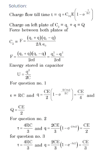

I didn't quite get much of the question as well; so can we say this question is absolutely wrong?
However the solution of this question is interesting, just putting it up for you guys to see, i literally can't find any logic how they derived it.

I don't understand this. The solution presents answers to 3 questions all of which are some kind of charge. The statement of the problem does not list 3 questions but asks us to "appropriately (match) the information given in the three columns of the following table."
I wouldn't say that this question is absolutely wrong, but that it is not at all formulated for people who cannot read minds. I am sure it makes sense to the person who wrote it and put out a solution. However, even with the solution in front of me, I cannot figure out what that sense is.
