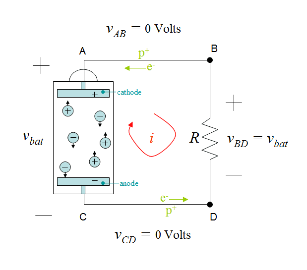

I've attached the diagram below to make sure we're both on the same page with what we are talking about.
Circuit schematic of a cell connected in a loop with resistor R, labelled nodes A, B, C, D, voltages vAB = 0 V, vCD = 0 V, vBD = vbat, and a clockwise current arrow i.
Part of your question about the cell, but let's discuss the other parts of the circuit first (get the low-hanging fruit).
Notice I added a resistor to the circuit. This is important. If we were to model the cell as an ideal voltage source and connect the terminals together directly with an ideal wire, we'd end up with infinite current. In a real-world situation, the current wouldn't be infinite, but it would still be very large and possible cause your circuit to melt or start fire. The reason it wouldn't be infinite is because the cell and wires themselves actually have a small amount of resistance associated with them that would limit the current. But we're not trying to model those things here, so I added an external resistor to keep things simple.
//// Wire AB
  • The wire is a conductor. The electric field inside a conductor is zero. However, electrons are able to move through the conductor (and in a typical circuit like this the generally move very slowly on average -- maybe a centimeter or less per second). But for every electron leaving to the left into the cell, there is another electron entering from the right from the resistor.
  • The total charge on the wire is essentially zero. Even though the electrons are moving, for every electron in the wire there is also a proton in the wire. So there is no net charge on the wire. (There might be a very, very small net positive charge on wire AB. This is because wires AB and CD act like a very, very weak capacitor. But for our purposes we can ignore this very small net charge.)
//// Resistor
  • As the electrons move from D to B, they lose potential energy. Pretend you and your friends are electrons, and you all fall down a very steep hill. Also imagine that there are many, many other people in front of you that have just fallen down the hill, and many others behind you about to fall down the hill. Gravity is the force that accelerates you down the hill, but don't accelerate down the hill uniformly. Instead you bounce off rocks and boulders, not to mention smashing into your friends repeatedly. Oh, the humanity! The end result is that your initial potential energy gets converted into thermal energy from all the crashing and bumping.
  • There is an electric field in the resistor, and thus a potential (voltage) across the resistor. This is equal to the electric potential of the cell.
//// Wire CD
  • See wire AB above, for the same concept, just reverse the direction. The only real difference is that electrons on wire CD will have a higher potential energy than those on wire AB. It's analogous to wire CD being on a level plateau near the top of steep hill (the resistor) and wire AB being a level plateau at the bottom of the steep hill.
//// Cell (battery)
  • This is where things get a little complicated.
  • Ions exist in the electrolyte solution from the beginning. The reason the ions don't combine and neutralize with themselves is a matter of chemistry.
  • The ions in the electrolyte solution chemically react with the anode and cathode. This causes new compounds to form at one or both of the electrodes.
  • These new compounds can often "plate" the electrode causing its exterior to be something different than it was previously.
  • Depending on the cell composition, the surface of an electrode might even dissolve in the process, becoming part of the solution in ion form.
  • Cations move to the cathode and anions to the anode mainly through the process of diffusion. As soon a few ions of a given type react with the corresponding electrode, they are no longer ions. Other ions move into take their place via natural diffusion.
  • Reactions at the catode leave a leftover positive charge. Reactions at the anode leave a leftover negative charge. Since the electrodes are conductors, electrons are able to leave the anode (removing the net negative charge on the anode); or in the case of the cathode, be neutralized by an entering electron.

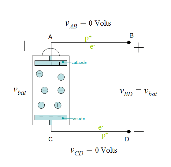

Now look what happens when we make the resistor very large -- or even better, let's just remove it from the circuit.
Circuit diagram of a battery between points A, B, C and D, with v_AB = 0 Volts, v_CD = 0 Volts and v_BD = v_bat; charge carriers shown inside the cell and in the wires.
In the above circuit, a few chemical reactions take place leaving behind the leftover charges on the electrodes. This does cause an electric field. This field inhibits the cations from reaching the cathode, and the anions from reaching the anode. The end result is that no more chemical reactions take place (well, almost no more), and the cell reaches a state of equilibrium.
I also need to know that they give the electrons electrical potential energy as a result of their stored chemical energy transformation.
The chemical reactions involved so far are chemically spontaneous. The results of the reactions produce energy, in the form of electrical potential energy of the electrons at the anode (and in wire CD).
Now you might be asking, "why don't the reactions spontaneously happen in reverse? Energy is conserved either way, so why does it only happen one way spontaneously?" The answer has to do with entropy and the second law of thermodynamics. Only the way described above causes the overall entropy to increase.

  • Circuit schematic of a cell connected in a loop through a resistor R, with nodes A, B, C, D, labelled voltages v_AB = 0 V, v_CD = 0 V, v_BD = v_bat, and a red loop arrow labelled i.
  • Circuit schematic of a battery connected by wires to points A, B, C and D, with v_AB = 0 Volts, v_CD = 0 Volts and v_BD = v_bat; cathode is marked with plus charges and anode with minus charges, and electrons and protons are labelled on the wires.
