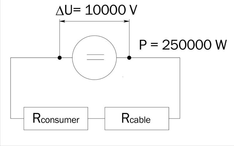

I think the situations looks like in the attached picture. Any thoughts?
  • Circuit schematic of a DC source with voltage labelled ΔU = 10000 V and power P = 250000 W, feeding a series loop containing R_consumer and R_cable.

Inspite of the nice explanations I am not getting it. So I think I should revise my basics and come back. Thanks a lot.

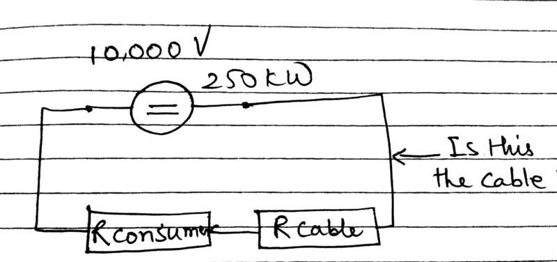

Is this the cable in the attached diagram
  • Hand-drawn circuit schematic on lined paper: a source labelled 10,000 V and 250 kW in series with R consumer and R cable resistors in a closed loop, with an arrow pointing to the cable resistor and the handwritten note Is this the cable.
The way the question is phrased could account for part of your problem. If you know the power being supplied and you know the volts then you can easily work out the current flowing (same through the cable AND the load). With the information in the question, there is no need to know the cable resistance but if you had been told the generator volts, the cable resistance and the power dissipated in the load, the question becomes more interesting. OR, if you had been told the volts across the load OR a number of other combinations of information, the question would also be more complicated.
Sarrah said:
What is the reason for the different answers?
Your first result for current is correct. What would be the point of using that calculated value of current to re-calculate it another way? :wink: But that second calculation of yours is assuming that all the power is being dissipated by the cable and not by the (load plus cable in series).
What you call the 'correct' answer is presumably the answer given in the back of the book. Your first answer is the correct one and your book is wrong (not a rare occurrence). COMPLAIN to your teacher and present him / her with the right calculation. Go on, I dare you.
No, the line is just a auxiliary line to see how the different components are connected. The rectangle containing the symbol ##R_{cable}## corresponds to the cable itself. The rectangle insinuates that the cable is treated as a ohmic resistance in which, due to friction between the conducted electrons with the nuclei, part of the electrical energy is transformed into heat (therefore the cable's temperature increases when current is flowing). This friction results in a drop of voltage (very similar to the pressure drop in pipe). Do you know the rules about volatges and currents in a closed circuit?

The first is correct.
Once you have done the first then you can use Ohm’s law to calculate the voltage drop on the cable. That turns out to be 300 V, and the 9700 V is across the load
