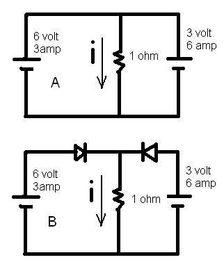

So I'm trying to understand the relationship between current & voltage as well as the basic electricity laws and Diode operation. Attached are 2 circuit diagrams for reference. Assume that Diodes can withstand against whatever voltage/current the circuit generates.
Can Anyone explain me what will happen in each circuit A & B?
Circuit A : What would be the value of Current and voltage across the load of 1 ohm?
Circuit B : What would be the value of Current and voltage across the load of 1 ohm?

The first circuit is too difficult to give a result for. When you put different voltage batteries in parallel, the larger voltage one will try to charge the other. So, don't do that.
The second one is also too difficult.
The current in the 1 ohm resistor would be about 5 amps (6 volts minus 1 volt for the diode divided by 1 ohm) but this would exceed the rating of the 6 volt battery.
In each case, you need to know the internal resistance of the batteries to work out what would really happen.
Just to get some sort of an answer, I assumed all the batteries had an internal resistance of 0.2 ohms.
This assumes the diodes have a drop of 1 volt at this current:
[PLAIN]http://dl.dropbox.com/u/4222062/currents.PNG
I was under impression that if V*I = same for both sides it will behave as symmetrical circuit and will add up current in 1 ohm resistor.
Here I don't understand why we can't get current addition in 1 ohm resistor per Ohm's/Kirchoff's laws?
What arrangement should be made in the circuit so we can get the sum of currents in 1 ohm resistor and approximately 5 volt across it, so that we can get approximately VI + VI = 2 VI kind of thing?
I don't want to go for series connection of batteries.
The current figures next to each battery are some sort of maximum current rating. That current will only flow if the load is correct for the voltage. That is the only way you can "tell" a battery how much current to deliver.
The problem is that you have two batteries in parallel with no resistance in the circuit between them. (This only refers to the outer loop.)
There is a net voltage of 3 volts (ie 6 minus 3) but zero resistance so the current will be infinite unless we know something about the internal resistance of the batteries.
There may be some current in the 1 ohm resistor, but until we know what the internal resistances of the batteries are, we can't calculate the current.
In the second circuit, the diode stops any current flowing into the 3 volt battery, but the current taken from the 6 volt battery is about 5 amps which exceeds the current rating of the 6 volt battery.

No, I mean to say the Circuit with Diodes in place. Won't the current from both batteries will flow into 10 Ohm resistor [addition of current?] and then again split exactly same way as it merged and flow back into Batteries?

Assume 1 volt drop across the diode in the left loop.
The current will be (6 volts minus 1 volt) divided by (6 ohms plus 10 ohms). so, 5 / 16 or 0.312 amps.
The voltage across the 10 ohms resistor is then 0.312 amps times 10 ohms or 3.12 volts. (V = I * R)
So, the diode on the right is reverse biased and cannot conduct any current.
