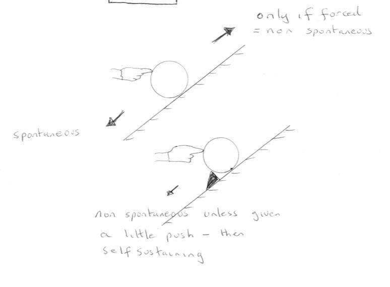

Processes may be spontaneous or non spontaneous and I have thought of a better example as in my sketches.
I hold a ball on a slope with my finger, as in the first sketch.
If I release the ball there are three scenarios.
1) The ball rolls downhill. This is the spontaneous process. It will commence of its own accord as soon as I let go and continue until it is stopped. That is it is self sustaining.
2) The ball rolls uphill. This is a non spontaneous process and will only occur if I push it. Further I will have to keep pushing to keep it going uphill. It is non self sustaining.
3) The fairy tale – the ball leaves the slope and flies away.
The spontaneous process is self starting (=spontaneous) and self sustaining because the ball is moving towards a position of lower energy – potential energy in this case.
Moving uphill means it is moving to a position of higher energy.
Now suppose there is a small step in the slope, as in the second picture.
The ball will not start to roll down the slope even after I remove my finger, until it has been lifted over the step.
This means it has to be pushed a small way uphill first, in the direction of increasing energy. Once it is over the step the process is self sustaining.
This small energy input to start an otherwise self sustaining process is called activation energy and is one reason why many processes that appear energetically favourable do not occur in real life.
I think that is enough to start. Please confirm you are still with me.
