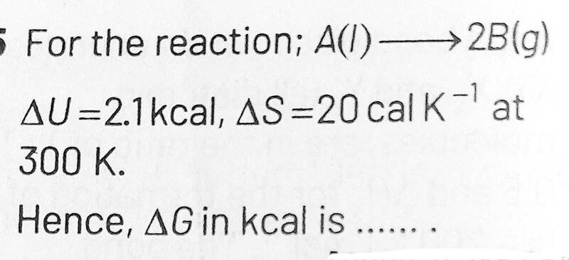

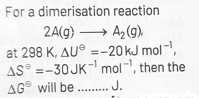

Most questions we have on Gibb's Energy are either on spontaneity, or application of that formula in isothermal case.##\Delta G=\Delta H-T\Delta S##
##\Delta H=\Delta U +\Delta n_gRT##
Like
What is your understanding of what ##\Delta G^0## or ##\Delta G## represents in these problems?
Since it represents the useful work, I take it to be the extra energy to be provided or the energy released after comtribution from the environment.##[-\Delta(TS)]##
It represents the change in G in going reversibly from pure reactants in separate containers at T and P to pure products in separate containers at T and P. The useful work and heat added depend on process path.
