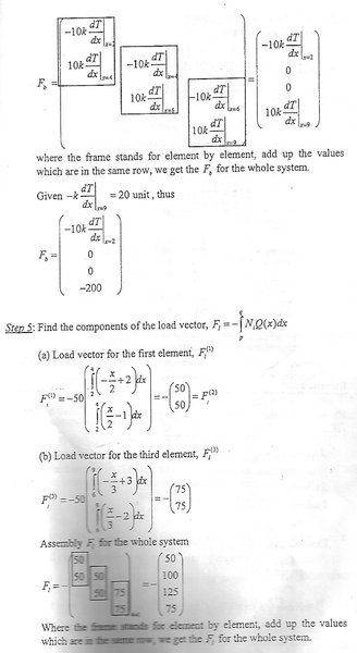

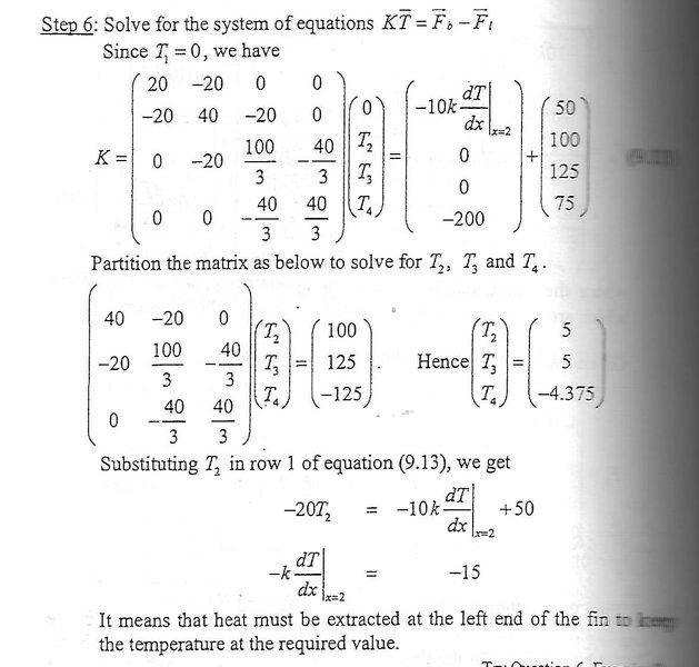

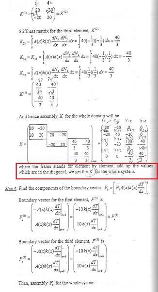

In the third picture , I don't understand the circled part , add up the values in the diagonal .. How to do that ?

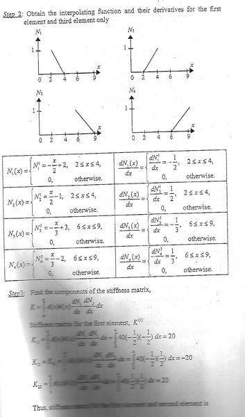

I don't understand how to get k13 , k14 , k21 , k22 , k33, k41 and k42 .
As we see in the second picture , the k21 and k22 = -20 and 20 respectively , why in the third picture , the k1 and k22 become -20 and 40 ?
Is the solution provided wrong ?

I tried add up 20, 40, 100/3, and 40/3 , i get 230/3 , none of the number in the matrix is 230/3!
why there's 3 boxes ? Why don't the author directly put it into the matrix as k11 , k12 , k21 , k22 , k33 , k34 , k43 and k44 only ?
