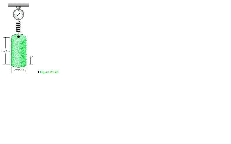

Hello All,
This problem comes from the book: Fundamentals of Engineering Thermodynamic.
I actually have the answer attached, but I am looking for some help understanding it.
From a non-calculus perspective, I can put the equation into this form with the position (z) left as a variable.
F = [ 7800 - 360*(z/2) ] * [[tex]\pi[/tex]*(0.25^2)] * [9.78]
But I am having real trouble understanding how to solve for z.
Thanks in advance.

  • Diagram of a cylinder hanging from a spring scale attached to a ceiling; the cylinder is labelled L = 2 m tall and D = 0.5 m wide, with a vertical z axis beside it, captioned Figure P1.20.

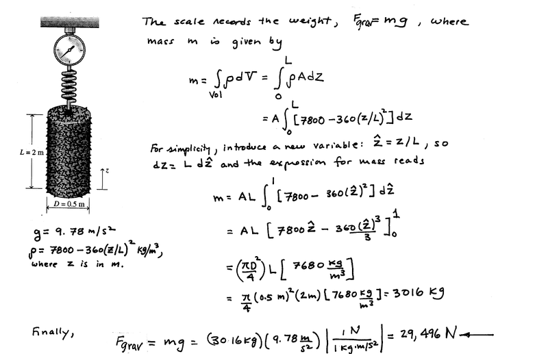

  • Handwritten solution: scale reads weight Fgrav = mg; mass integral of density over volume, m = A times integral of 7800 - 360(z/L)^2 dz from 0 to L, giving m = 3016 kg and Fgrav = 29,496 N.

What do you mean 'from a non-calculus perspective'? You need calculus to solve for the mass of the cylinder. You're not solving for z, z is the position along the cylinder.
Hint: Think of the cylinder as composed of disks of thickness dz. What's the mass of each disk? Integrate to get the total mass of the cylinder.
