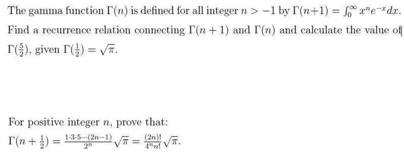

Gamma(n+1) = n(gamma(n))
I have searched around trying to figure out how to do this. So far I have come out with:
Gamma(n) = (n-1)(n-2)...
Gamma(n+1)=n(n-1)(n-2)...2(1) otherwise known as Gamma(n+1)=n!
Problem is... I don't fully understand what I did because I followed a like example. Can someone please help me out with this. Also I have not even attempted the second part, so ignore that for now.
First part.
\Gamma(n+1) = n\Gamma(n)
\Gamma(\frac{5}{2})=\Gamma(1+\frac{3}{2})=\frac{3}{2}\Gamma(1+\frac{1}{2})=\frac{3}{2}\frac{1}{2}\Gamma({\frac{1}{2})=\frac{3\sqrt{\pi}}{4}
This part is for the proof.
Assume true for k
\Gamma(k+\frac{1}{2})=\frac{1.3.5...(2k-1)\sqrt{\pi}}{2^k}
Then prove for k+1
\Gamma(k+1+\frac{1}{2})=(k+\frac{1}{2})\left(\frac{1.3.5...(2k-1)\sqrt{\pi}}{2^k}\right)
Note the recursion relation, then,
\Gamma(k+1+\frac{1}{2})=\frac{1}{2}(2(k+1)-1)\frac{1.3.5...(2k-1)\sqrt{\pi}}{2^k}=\frac{1.3.5...(2k-1)(2(k+1)-1)\sqrt{\pi}}{2^{k+1}}
Complete the proof by proving for k=1 and hence all positive integers.
A little confused because I think you combined both parts of that. Both of those have nothing to do with each other, but otherwise you helped me with the first one.
I just worked out the value of 5/2 for the first one, and for the second I used the relationship we worked out at the beginning and proof by induction to answer the last part of it. I've separated them now too.

I'll clarify:
The question asks you to prove that
\Gamma(n+\frac{1}{2}) = \frac{1.3.5.7...(2n-1)}{2^n}\sqrt{\pi}
We can sort of see this in the 5/2 example, all the numerators are odd numbers and the denominator is always 2, so the odd numbers will multiply successively n-times on the top and 2 will be of the power n on the bottom, and always at the end is the square root of pi. To prove this first "assume" that it is true for any number say, k.
\Gamma(k+\frac{1}{2}) = \frac{1.3.5.7...(2k-1)}{2^k}\sqrt{\pi}
We assume this is true, and now we try to prove it for k+1, we want the next odd number to appear on the numerator and for another 2 to be multiplied in the denominator (or half on the numerator) to make the right hand side look like this:
\frac{1.3.5.7...(2k-1)(2(k+1)-1)}{2^{k+1}}\sqrt{\pi}
Once this happens all we have to do is show that the equation holds for n=1 and then we get it true for n=1,n=1+1 etc.
From the relationship we established,
\Gamma(n+1)=n\Gamma(n)
We can add 1 quite nicely:
Remember that we have assumed that
\Gamma[k+\frac{1}{2}] = \frac{1.3.5.7...(2k-1)}{2^k}\sqrt{\pi}
So for k+1:
\Gamma(k+1+\frac{1}{2}) = (k+\frac{1}{2})\Gamma(k+\frac{1}{2})
(k+1/2 is n here.)
\Gamma(k+1+\frac{1}{2}) = (k+\frac{1}{2})\frac{1.3.5.7...(2k-1)}{2^k}\sqrt{\pi}
Now all we need to do is rearrange it
(k+\frac{1}{2})\frac{1.3.5.7...(2k-1)}{2^k}\sqrt{\pi} = \frac{1}{2}(2k+1)\frac{1.3.5.7...(2k-1)}{2^k}\sqrt{\pi}
Notice that we have a half and a 2k+1, which if you look is actually (2(k+1)-1), our next odd number.
\frac{1}{2}(2k+1)\frac{1.3.5.7...(2k-1)}{2^k}\sqrt{\pi} = \frac{1.3.5.7...(2k-1)(2(k+1)-1)}{2^{k+1}}\sqrt{\pi}
So if it's true for k it is true for k+1, if you prove it for k=1 you have proved it then for all positive n.
\Gamma(1+\frac{1}{2}) = \frac{\sqrt{\pi}}{2} = \frac{1.\sqrt{\pi}}{2^1}
\Rightarrow \Gamma(n+\frac{1}{2}) = \frac{1.3.5.7...(2n-1)}{2^n}\sqrt{\pi}
For positive n.
Edit: The final part of the proof would just be manipulating the expression to match the RHS.
