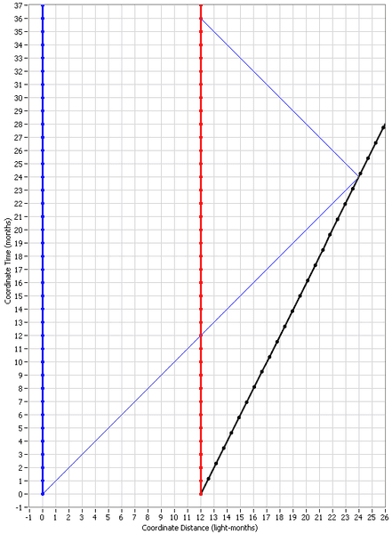

Ok, well here's a spacetime diagram to illustrate your scenario. The emitter is shown as the thick blue line and sends out a pulse of light shown as a thin blue line. It arrives at A shown in red and continues on to B shown in black at the coordinate time of 24 months or two years but A doesn't see this happening until the time of 36 months (or 3 years). The dots indicate the passage of one-month's intervals for each object. Note that B sees the light after about 20.8 months.

Choran,
The way you have this problem stated, it does not even involve relativity, since it all takes place in A's rest frame. It's just a standard algebra "word problem" involving trains, planes and automobiles. :smile:
The light ray starts from the origin and travels at velocity c. Therefore its path is x = ct.
Observer B starts at x = 1 and travels at velocity 0.5 c. Its path is therefore x = 1 + 0.5 ct.
They meet where these two paths intersect, namely ct = 1 + 0.5 ct. The solution is ct = 2, or t = two years.

I re-uploaded the diagram, can you see it now?
Yes George, I can see it now. I would have thought that A would see the light reach B one year after it arrived at his (A's) location. It passed him, and caught B a year later. Why three years?

George, I get the "three years". Where does the 20.8 months come from? Thanks again, buddy.
choran said:
... Where does the 20.8 months come from? ...
B sees the light after 24 months have passed according to clocks that remain stationary relative to E (blue line) and A (red line). According to a clock carried by B the elapsed time is 20.8 months due to the time dilation effect, because B is moving relative to E and A. (Count the dots along the black line).
You originally asked about the appearance to A of the light reaching B and now you're asking about what A would see. Those questions are frame invariant.
The question of when the light reaches B in the rest frame of E and A applies only to that one frame and can be easily seen (by us, not by A) in the diagram above. Now after A receives the image coming from B, he can use the time on his clock when the light pulse passed him (1 year) and the time on his clock when he saw the reflection (3 years) and assume that the light took the same time to get from him to B as it did to get from B back to him and conclude (by averaging) that the light arrived at B at his own 2-year mark.

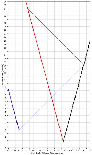

Now I'm going to use my software to transform the diagram for the rest frame of E and A into the rest frame of B (after he departs from A):
Note that in this frame, the arrival of the light at B occurs at A's time of 18 months instead of 24 months as it did in the previous frame. However, B still sees the light arriving at his location when his clock is at 20.8 months (count the dots) and A still sees the reflection at his time of 36 months, even though in this frame it is A that is experiencing Time Dilation instead of B as in the original frame. And since A's observations are the same in this frame as in the original frame, he can still make the same assumption about the time it takes for light to propagate each way, even though there is a 3-to-1 difference in this frame and he can arrive at the same conclusion that the light arrived at his 24-month mark instead of his 18-month mark.All the observers are completely oblivious to the coordinates specified in the different frames that we use to describe scenarios.
Now let's take this one step further. Let's assume that when A receives the reflection of the light pulse off of B at his own time of 36 months, he also observes that B's clock was reading 20.8 months. Now since A has determined that the reflection happened at his own time of 24 months, A can calculate the ratio of the rate of his own clock to B's clock. He gets 24/20.8 = 1.154. This, by the way, is the Lorentz factor for the speed of 0.5c. Keep this in mind for later.

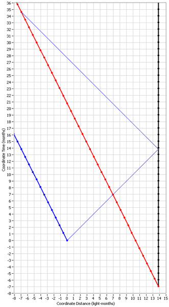

Finally, I want to show you another frame in which all parties, E, A, and B are all traveling at the same speed, 0.268c.
In this frame, all parties are experiencing the same Time Dilation with respect to the coordinate time and yet all parties make the same observations as they did in the other two frames. This should be telling--different frames have no bearing on what any observer actually sees.
And in this frame, A's clock is also at 20.8 years when the light gets to B but A still continues to determine that it arrived at 24 months. He also continues to determine that the Time Dilation of B's clock is 1.15 and if B sends out a burst of light at his time of seven months, B determines that the Time Dilation of A's clock is 1.15.
