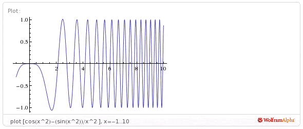

Try to modify a sine or cosine function, so that its amplitude decreases as x➙∞ , but oscillates more and more rapidly as x➙∞ . If it oscillates rapidly enough, then the derivative may oscillate with constant or increasing amplitude. Therefore, the limit derivative will not converge as x➙∞ .
See the image of a graph of such a first derivative, f'(x).
...Plotted in WolframAlpha.

I came up with this :
f(x)=2+sin(x3)/x
so f'(x) = sin(x3)/x2-3cos(x3) and it is not stable at infinity because of cos(x3),right?
Please tell me if it is ok or not. Thank you.
