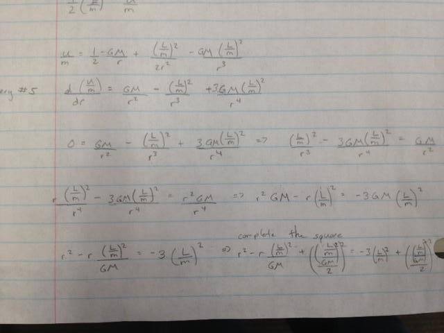

I have one last question on the lab assignment regarding to Query #5.
I'm getting an incorrect expression when working with Einstein's equation to determine the perihelion of Mercury. At the end of the equation I'm getting a negative number within the radical of my 2nd pic near the end.
I don't know if I did a calculation incorrectly or the formula was given to me incorrectly. I also added in the gravitational constant G to the formula.
1st Page:
2nd Page:
image-1_zps5276ba49.jpe
Let me know if you can read the images, sorry for the small writing.
The units in the last equation do not match. Just check them in your formulas, and you will find the error.
