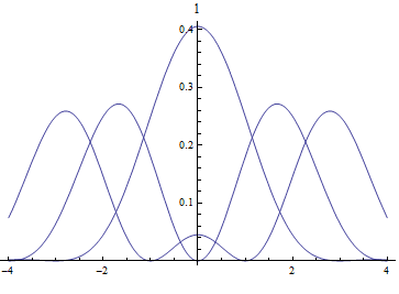

Hi, snoopies622.
Fig.1 is wave function of momentum eigenstates p=h'/λ and p=-h'/λ superposed in equal weight.
Fig.1
Fig.2 is wave function of an energy eigenstate in infinite square well potential.
Fig.2
Though Fig.1 and Fig.2 coincide within the well region, They are different states. Fourier transform of Fig.2 gives continuous momentum spectrum. See Schubert.
You can rewrite En as pn^2/2m where pn is a quantity whose dimension is momentum, but pn is not momentum of the system. However as classical limit taking n large, the state momentum tends to +-pn. See Schubert Fig3.2.
Regards.

Hi, snoopies622
snoopies622 said:
Why does this restriction not apply to energy eigenfunctions as well? They are both sine waves after all, which by definition extend forever in both directions.
Why not? Read remind to you in my post #26, please. Energy eigenfunctions are sinusoidal waves in the well and are zero outside.
Do not be bored to see the same Figures again. They are NOT like Fig.1
Fig.1 (superposition of two) momentum eigenstate(s)
but like Fig.2.
Fig.2 an energy eigenstate
Regards.
