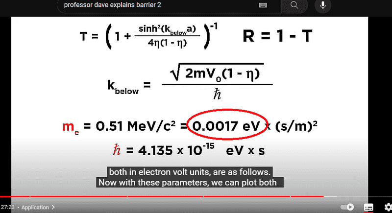

I am continuing watching Dave's videos, in particular about the barrier:
Here are his formulas:$$\psi (x)=A e^{i k_0 x}+B e^{-i k_0 x}$$
For x<0
$$\psi (x)=C e^{i k_0 x}$$
For x>a
$$\psi (x)=F e^{k_b x}+F e^{-k_b x}$$
For 0<x<a
$$k_0=\frac{\sqrt{2m E}}{\hbar}$$
$$k_b=\frac{\sqrt{2m (U_0 - E)}}{\hbar}$$
The boundary conditions (equality of the wavefunctions and their first derivatives) produce theese equations:
$$A+B=F+G$$
$$ik_0 A -ik_0 B=k_b F - k_b G$$
$$F e^{k_{b}a}+G e^{-k_{b}a}=C e^{i k_0 a}$$
$$k_b F e^{k_{b}a}-k_b G e^{-k_{b}a}=i k_0 C e^{i k_0 a}$$
The solution of this system leads to
$$\frac{C}{A}=(1+\frac{\sinh^2(k_b a)}{4 \eta(1-\eta)})^{-0.5}$$
$$\eta=\frac{E}{U_0}$$
Then Dave performs calculations with this formula, and gets the following: if the barrier height is 1 micro-electronvolt and the barried thickness is 0.1 nanometer, then the tonnel effect is clearly seen (e.g. if the electron energy is 20% of the barrier height, nearly 20% of electrons pass the barrier).
If the electron energy higher than the barrier, we get this formula:
$$\frac{C}{A}=(1+\frac{\sin^2(k_b a)}{4 \eta(1-\eta)})^{-0.5}$$
This formula shows the second interesting effect - oscillations (it includes a sin wave).
I am afraid that Dave was wrong with the calculations; anyway, are these two formulas correct?
I have found an error in Dave’s video:
Slide of transmission and reflection formulas: T = (1 + sinh^2(k_below a)/(4η(1-η)))^-1, R = 1 - T, k_below = sqrt(2mV_0(1-η))/ħ, with me = 0.51 MeV/c^2 = 0.0017 eV x (s/m)^2 circled in red and ħ = 4.135 x 10^-15 eV x s.
Trying to calculate all myself by his formula:
$$\frac{C^2}{A^2}=(1+\frac{\sinh^2(k_b a)}{4 \eta(1-\eta)})^{-1}$$
$$k_b=\frac{\sqrt{2m (U_0 - E)}}{\hbar}=\frac{\sqrt{2m U_0 (1- \eta)}}{\hbar}$$We have the barrier height $$0.4 eV=6.40872 \cdot 10^{-20} J=6.40872 \cdot 10^{-20} kg \cdot m^2/c^2$$, barrier thickness $$1nm=10^{-9} m$$, electron mass $$9.109 \cdot 10^{-31} kg$$, $$\hbar=1.055 \cdot 10^{-34} J \cdot c=1.055 \cdot 10^{-34} kg \cdot m^2/c$$, $$\eta=0.5$$$$K_b=\frac{\sqrt{2 \cdot 9.109 \cdot 10^{-31} kg \cdot (6.40872 \cdot 0.5) \cdot 10^{-20}kg \cdot m^2/c^2}}{1.055 \cdot 10^{-34} kg \cdot m^2/c}=1,62009 \cdot 10^9 m^{-1}$$$$\frac{C^2}{A^2}=(1+\frac{sinh(1,62009 \cdot 10^9 m^{-1} \cdot 10^{-9}m)}{4 \cdot 0.5 \cdot (1-0.5)})^{-1}=0.73$$
So, I found that the tunnel effect is clearly seen if the barrier thickness is 1 nm and the barrier energy is 0.4 eV. Is that correct?
  • Slide with formulas: T = (1 + sinh²(k_below a)/(4η(1 − η)))⁻¹, R = 1 − T, k_below = √(2mV₀(1 − η))/ħ, m_e = 0.51 MeV/c² = 0.0017 eV × (s/m)², ħ = 4.135 × 10⁻¹⁵ eV × s, with 0.0017 eV circled in red.

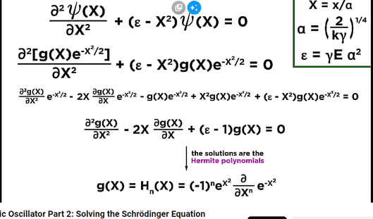

I am continuing watching Dave (harmonic oscillator):
This blog provides a relatively convenient format, although I am afraid the author can produce errors.
We have SE:
$$-\frac{\hbar}{2m}\frac{d^2 \psi(x)}{dx^2}+\frac{1}{2}k x^2 \psi(x)-E \psi(x)=0$$
For convenience we change x to X:
$$\frac{d^2 \psi(X)}{dx^2}+\varepsilon \psi(X)-X^2 \psi(X)=0$$$$X=x/ \alpha$$
Then Dave says that this equation is solved via Hermite polynomials:
Handwritten-style derivation on a slide: d²ψ(X)/dX² + (ε − X²)ψ(X) = 0; X = x/α; α = (2/(kγ))^(1/4); ε = γE α²; then d²[g(X)e^(−X²/2)]/dX² + (ε − X²)g(X)e^(−X²/2) = 0, expanded to a g(X) equation, with the solutions stated as Hermite polynomials g(X) = H_n(X) = (−1)^n e^(X²) ∂^n/∂X^n e^(−X²).
I don’t understand, where does epsilon go? Can you help me understand this?
BvU said:
Well, you can check that the wavefunctions satisfy the original equation ...
Yes, and that will show you how ##n## and ##\epsilon## are related to each other.
I have checked the solution. Again, we have this SE:
$$\frac{d^2 \psi(X)}{dX^2}+(2n+1) \psi(X)-X^2 \psi(X)=0$$
$$X=x/ \alpha$$
For solving it, it is convenient to use g(x):
$$\psi(X)=g(X) e^{-X^2/2}$$
The sulution is as follows:
$$g_n(X)=(-1)^n e^{x^2} \frac{d^n}{dx^n}(e^{-X^2/2})$$
$$g_0(X)=1$$
$$\psi_0(X)=e^{-X^2/2}$$
$$\frac{d^2(e^{-X^2/2})}{dX^2}+e^{-X^2/2}-X^2 e^{-X^2/2}=\frac{d(-X e^{-X^2/2})}{dx}+e^{-X^2/2}-X^2 e^{-X^2/2}=$$
$$=-e^{-X^2/2}+X^2 e^{-X^2/2}+e^{-X^2/2}-X^2 e^{-X^2/2}=0$$
$$g_1(X)=2X$$
$$\psi_1(X)=2X e^{-X^2/2}$$
$$\frac{d^2(2X e^{-X^2/2})}{dX^2}+3 \cdot 2X \cdot e^{-X^2/2}-X^2 \cdot 2X \cdot e^{-X^2/2}=$$
$$=\frac{d(2 e^{-X^2/2}-2 X^2 e^{-X^2/2})}{dx}+3 \cdot 2X \cdot e^{-X^2/2}-X^2 \cdot 2X \cdot e^{-X^2/2}=$$
$$=-2X e^{-X^2/2}-4X e^{-X^2/2} +2X^3 e^{-X^2/2}+3 \cdot 2X \cdot e^{-X^2/2}-X^2 \cdot 2X \cdot e^{-X^2/2}=0$$
