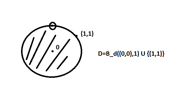

The following definition is given:
A set $U \subset \mathbb{R}^n$ is called open if for each $x \in U$ there is $B_d(x, \epsilon) := \{ y \in \mathbb{R}^n: d(x,y)< \epsilon\}$ -> open ball with center $x$ and radius $\epsilon$.
Could you explain me why the following set is open?
Why is the following set closed?
View attachment 4787Why is the following set neither open nor closed?

Hey evinda! (Smile)
I think your definition should also include that the ball has to be a subset of $U$.
Anyway, it's all about the boundaries.
In your drawings it is not clear if the boundary is part of the set or not.
Presumably in your first drawing it's not, so that we have a ball around each of the inner points, such as $y$, that are indeed part of the set.
In the second drawing, I can only assume that the white parts represent open sets.
Therefore their complement, the shaded part, is closed.
For reference, a closed set is defined as the complement of an open set. (Nerd)
In the third drawing, any ball around (1,1) will not be a subset.
Therefore $D$ is not open.
The complement of $D$ has many points on the boundary for which no ball will be a subset.
It follows that the complement is not open, and thus $D$ is not closed. (Mmm)

For example, the set $\{(x,y) \in \Bbb R^2: x^2 + y^2 < 1\} \cup \{(1,0)\}$ is neither open nor closed.
It is not open because $(1,0)$ is a boundary point, it is not closed because it does not contain the boundary point $(0,1)$ (along with many, many others).

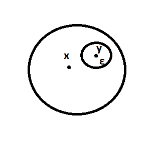

evinda said:
So if we suppose that the boundary is not part of the set, then do we know that the set is open since the boundary is a ball with center $x$ and radius greater than $\epsilon$? Or have I understood it wrong? (Thinking)
The $x$ in the definition is different from the $x$ in the drawing. (Worried)
In the drawing we have some point $x$ with around it a set $U$ that may or may not be a ball.
Either way, it does not have radius $\epsilon$.
To apply the definition of an open set, we introduce a new symbol $y$ that takes the place of $x$ in the definition, since $x$ is already in use. (Nerd)
So for every $y$ in $U$, we need that there is some $\epsilon > 0$ however small, such that the mini ball around $y$ with radius $\epsilon$ fits inside $U$.
If the boundary of $U$ is not part of the set, this is always possible.

I am a little confused right now. Do we suppose that only $x$ is given and $U$ is the area around $x$? Or have I understood it wrong? (Thinking)
Yes! (Smile)

So doesn't the fact whether there is a mini ball around $y$ with radius $\epsilon$ fits inside $U$ depend on $x$?
Also what happens if the boundary of $U$ is part of the set?
Yes, if $x$ is on the "very edge" of $U$ (the boundary), no ball around $x$ will "fit inside" $U$, it will "spill over" to the complement.
If $U$ contains part of its boundary (even just one point), it will NOT be open.
Does it hold that any ball around $(1,1)$ will not be a subset because of the fact that $(1,1)$ is at the boundary?
In general, does it hold always if a point of the boundary is included in $D$ that $D$ will not be open?
Could you explain me further the following?
- - - Updated - - -
Also there is the following definition:
A set $K \subset \mathbb{R}^n$ is called bounded if there is a $\Lambda>0$ such that for each $x \in K$,
$$d(x,0)< \Lambda \text{ or equivalently } K \subset B_d(0, \Lambda)$$
How can we apply this definition if we are given a graph of a set?
evinda said:
So do we assume that the boundary of the inner sets are not included?
If so, is the boundary included at the complement? (Thinking)
The boundary of the inner sets would be included in the shaded set.
That's what we need for it to be closed. (Nerd)
Yes. (Nod)
The complement of $D$ consists of everything outside the set, including the boundary, except for (1,1).
Since it includes points on the boundary, it cannot be open. (Thinking)
