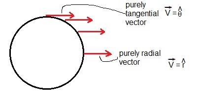

It seems as if this discussion has flown way past the point of giving simple examples of parallel transport, but it always helped me to understand the simplest cases first, before moving onto the abstract general theory.
The two cases that were most helpful to me in understanding parallel transport, intuitively, were:
  1. Parallel transport of vectors in 2D Euclidean space described using polar coordinates.
  2. Parallel transport of vectors on the surface of a sphere.
Figure 1: Parallel transport in polar coordinates
In Figure 1, I show the parallel transport of a vector [itex]\vec{V}[/itex], shown in red, around a circle. Initially, the vector is purely radial, so in polar coordinates, you would write [itex]\vec{V} = \hat{r}[/itex]. Then after you parallel-transport the vector 1/4 of the way around the circle counterclockwise, the vector is pointing purely tangentially, so in polar coordinates, you would write: [itex]\vec{V} = -\hat{\theta}[/itex]. So the components of the vector change even though the length and direction of the vector remains the same. The connection coefficients describe how the components of a vector change as the vector is parallel-transported.
Note 1: The picture says [itex]+\hat{\theta}[/itex], but the usual convention is that [itex]\theta[/itex] increases counterclockwise, which would make the vector in the negative [itex]\hat{\theta}[/itex] direction.
Note 2: The use of the notation [itex]\hat{r}[/itex] and [itex]\hat{\theta}[/itex] means a unit vector in the direction of increasing [itex]r[/itex] or increasing [itex]\theta[/itex]. Without a metric, there is no way to make sense of the notion of a "unit vector", but a metric is not necessary to make sense of parallel transport.

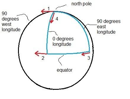

Figure 2: Parallel transport on a globe
In Figure 2, I show the simplest example that I know of of parallel transport in a curved space.
  1. Imagine standing at the North Pole facing South along the line 0 degrees longitude. Hold your right arm out to represent a vector that will be parallel-transported. Initially, your arm points south along the line 90 degrees west longitude (90 degrees away from the direction you are facing). The vector drawn in red represents the direction your arm is pointing.
  2. Now, march straight south along the line of 0 degrees longitude until you reach the equator. Keep facing the same direction (south) and keep your right arm pointing to your right. At this point you are at the equator, and your arm is pointing straight west.
  3. Now, sidestep your way east along the equator until you reach the line of 90 degrees east longitude. Keep facing south, and keep your arm pointing to your right. At this point, your arm is still pointing east.
  4. Now, walk backwards, north along the line of 90 degrees east longitude until you return to the North Pole. At this point, even though you have tried to always keep facing in the same direction, you are now facing south along the line of 90 degrees east longitude, and your arm is pointing to your right, along the line of 0 degrees longitude. So even though you tried not to rotate, your travel in the big three-leg journey has rotated you and your arm through 90 degrees.
