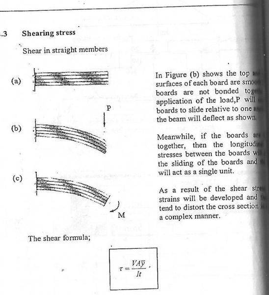

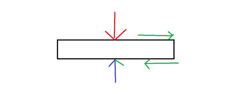

to resist the bending, there must be reaction force(blue) act against the applied force(red), the reaction force that resist bending is the longitidunal normal force , right?
why the author stated it as longitidunal shear force, is it wrong?
longitidunal shear force is the green colour arrow, right? how could the force resist the bending?
  • Textbook page titled Shearing stress showing three beam diagrams: (a) an unloaded straight beam of stacked boards, (b) the same boards bent downward under load P with the top surfaces sliding, (c) a curved bent beam with moment M, followed by the shear formula tau = VAy-bar / It.
  • Free-body diagram of a horizontal rectangular beam with a red downward arrow on its top face, a blue upward arrow on its bottom face, and pairs of green horizontal arrows pointing in opposite directions along the top and bottom faces.
Your own diagram is inaccurate in several ways.
The set-up is a beam fixed at one end, with a transverse load applied at the other, not in the middle. There is no source of a force to provide the support you show in blue.
You do not show any forces where the beam is fixed. These forces will consist of a vertically upward force to balance the load, plus a torque to balance the moment of the load. This torque is transmitted in the form of the longitudinal shear forces.
