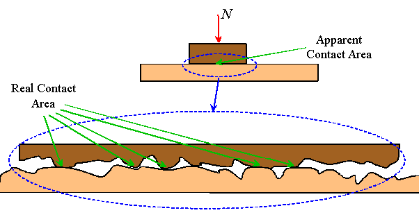

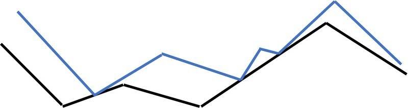

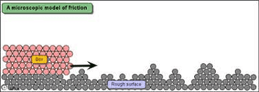

I think why there is a maximum starts to come more into focus when you consider microscopically what is going on:
This is what this mating surfaces of the box and truck look like. There is a certain amount of acceleration (inertial forces) or force that must be applied so the blue surface (box surface) can climb over the peaks and valleys of the truck bed (black line). Thats how someone explained it to me once, I'm not saying its fully developed theory (and I'm waiting to be lambasted for presenting it), but I think it answers the question you have.
I believe I have some degree of a working understanding of it. The box on top has the same acceleration as the truck, so we know a 'frictional force' is applied to the box from the truck, and is ##f = F_b = m_ba##, this is non negotiable since the box has the same acceleration as the truck, the truck has an equal and opposite force onto it, so we can write ##D - f = m_ta## where D is the driving force of the truck, we know that f will be growing as the driving force increases, but have a maximum value of ##f = m_ba = \mu g m_b## so we divide by ##m_b## and find the acceleration of the truck when the frictional force is at it's max, and that acceleration is ##\mu g##. After the acceleration of the truck is larger than, or equal to ##\mu g## the acceleration of the truck will increase for larger driving force, but the box's acceleration will remain constant. Of course the acceleration of the box will be different than the trucks once the frictional force is greater than or equal to ##\mu g## but I thought it would be more simple to write the equations with one acceleration variable.

Chenkel said:
I'm wondering what happens at the microscope level when the friction force reaction it's maximum value.
At the microscopic level, things become very messy. Each atom might be experiencing more/less/zero force at any particular instant. Forces on boundary atom can cause the crystal lattice of the solid to deform in many ways.
Friction is an average, and the averaging wipes out the microscopic differences. So when you study atomic forces with each atom modeled separately, there is no such thing as friction.
The same applies with temperature. Temperature is defined only for the average behavior of many particles. Look at just one particle and there is no such thing as temperature.
At that point the loose bonds between the surfaces break and you transform to a kinetic friction model.
