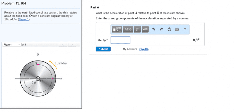

a= omega^2*r
a_A/B = a_A - a_B
a_A = 10^2*r (-î)
a_B = 10^2*r (+ĵ)
a_A/B = 10^2*r (-î) - 10^2*r (+ĵ)
=> -200 î -200 ĵ
why is the answer 200 î -200 ĵ (accelerate in +î direction) ?

The question is asking for the acceleration of A relative to B. What's the acceleration at A and at B independently?
Hint: Check the direction of acceleration vectors.

Err... isn't my expression correct..?
a_A = 10^2*r (-î). A is going -x, -y direction
a_B = 10^2*r (+ĵ). B is going -x, +y direction

No. Should your acceleration be tangential or radial to the disk? Remeber the disk has constant angular velocity.
should be tangential because constant radius??
Actually it should only have radial acceleration. Can you see why?
because constant rotation?
so the a_r for B is pointing from point B to Point O
and for A it is pointing from Point A to Point O?
Exactly, so what's your relative acceleration now?
so the a_r for B is omega^2*r (-i)
a_r for A is omega^2*r (-j)
a_A/B = a_A - a_B = -omega^2*r (j) - -omega^2*r (i)
rearrange = omega^2*r (i) - omega^2*r (j)
Got it! Thanks!
