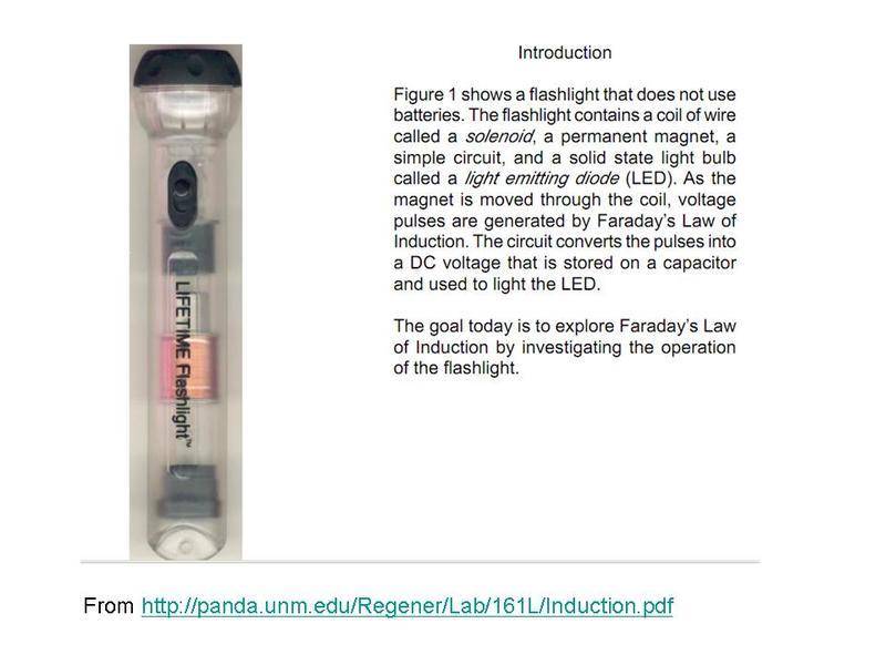

Hi Bill-
Your original description of the cylindrical magnet inside s solenoidal coil sounds more like the flashlight in the thumbnail. A cylindrical permanent magnet moves up and down inside a copper solenoid coil seen in the center of the flashlight.
Bob S
  • Photo of a transparent plastic flashlight labelled LIFETIME Flashlight, next to a page of printed introduction text about Faraday's Law of Induction and a solenoid, permanent magnet and LED.

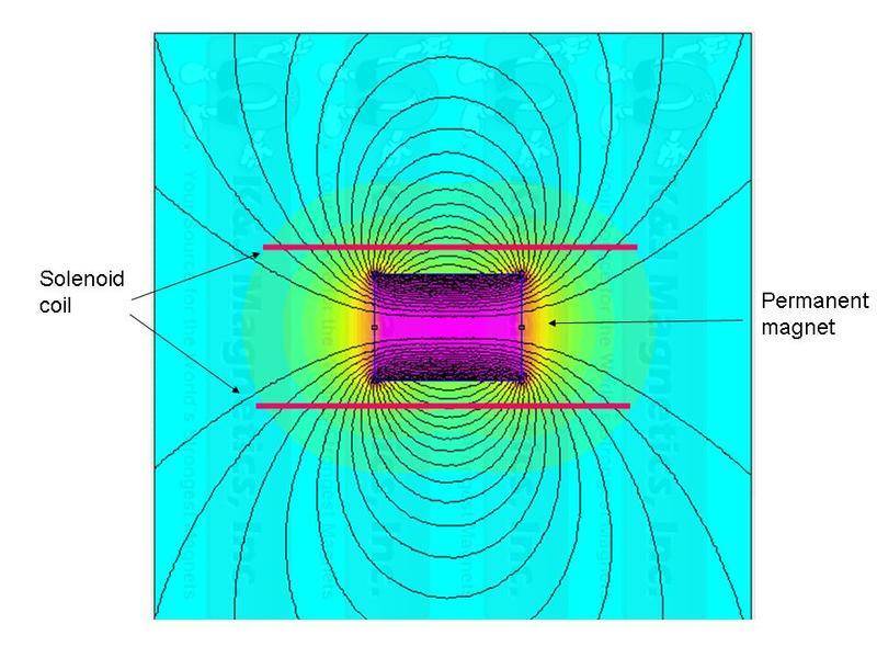

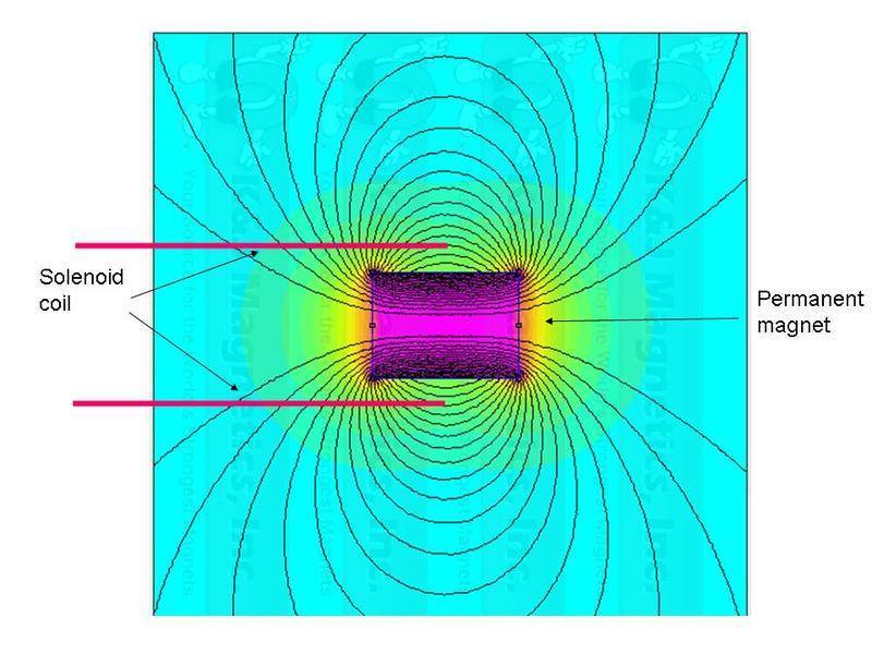

Here are two thumbnails showing the magnet in the center and at the end of a solenoid coil. Is the flux linking the coil in either thumbnail? If the magnet is moving in the center of a long solenoid, is there any d(MF)/dt in the solenoid?
Thanks for the link to the K & J neodymium magnet field calculator: http://www.kjmagnetics.com/fieldcalculator.asp
Bob S
  • Simulated magnetic field plot of a rectangular permanent magnet inside a solenoid coil shown as two horizontal bars, with flux lines looping around the magnet and labels Solenoid coil and Permanent magnet.
  • Simulated field plot of a rectangular permanent magnet between two horizontal solenoid coil cross-sections, with dense curved flux lines around the magnet and labels for solenoid coil and permanent magnet.
