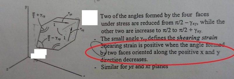

In the notes , refer to the circled part . It 's stated that the shearing strain is positive when the angle formed by two surfaces oriented along positive y and x axes decreases ..
. As we can see from the figure( paralleogram ) , one of the angle increases , while another angle decreases , am i right ? Why the author said angle decreases ?
Here it is

chetzread said:
...angle formed by two surfaces oriented along positive y and x axes decreases ..
I think that could be stated more clearly. Obviously there are two surfaces oriented along each axis. To match the description to the diagram, try rewording it to:
"...angle formed by two surfaces closest to the origin and oriented along positive y and x axes decreases .."
what do you mean by it ? Can you explain further ?
Tom.G said:
"...closest to the origin..."
closest to the origin of the graph as shown in the image of your post #2.
-or-
the two faces closest to and facing the X-Z and Y-Z planes.
https://www.physicsforums.com/attachments/img_20161015_102808-jpg.107454/
if the downwrads plane is sheared to the right , and the upper planes sheared to the left , then the angle formed by two surfaces closest to the origin and oriented along positive y and x axes will increase , right ?.
Right!
