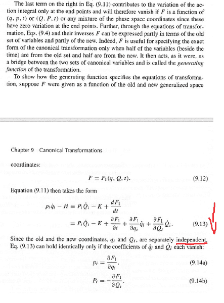

There's a part in my book that I don't understand. I have attached the part and it is basically about how to transform from a set of conjugate variables (q,p) to another (Q,P) while preserving the hamilton equations of motion. I don't understand what he means by q,Q being separately independent. Don't we seek transformation where Q is a function of q. Maybe I'm just not into what he means by this independency.

It's true, but he means that for F q and Q are variables, so that there's no linear dependence between their time derivatives. Such a linear dependence would spoil his argument.
Please elaborate. If Q = Q(q,p,t) how is its time derivative independent of q? :(
Well, what is said was that there is no linear dependence between [itex]\displaystyle{\dot{Q}}[/itex] and [itex]\displaystyle{\dot{q}}[/itex].
but dQ/dt = [itex]\partial[/itex]Q/[itex]\partial[/itex]q dq/dt + ...
How is that not a relation between them?
