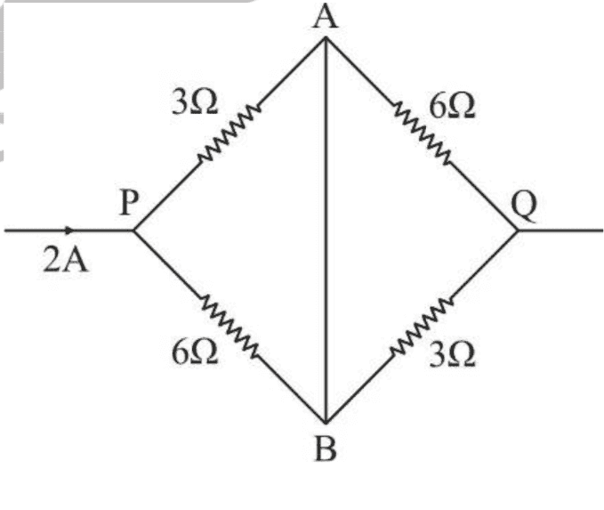

The question is to calculate the amount of current in AB, so I thought solving for the resistors would lead to the current value, but it won't be the case here. The assumption I used, was to convert AB into H shape wire, and then to solve for parallel resistors on both sides of AB. If I consider the 4 ohm answer, then 2 A current would flow through AB as it would be in series. But the correct answer is 0.66 A, which means we need to consider potential difference of A and B, and then apply Kirchhoff's law to find current in AB.

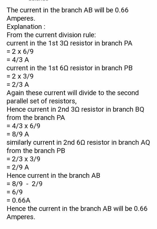

But the procedure is time-consuming, and I am supposed to solve such questions with shortcuts and tricks rather than direct formulas (it's for a competitive exam). So I googled it, and found a solution, whose screenshot I have provided alongwith circuit diagram.
It could be said I am basically asking for the short cut alternative for Kirchoff's law, but I know such an option exists, so I am asking for the explanation of the less time-consuming method.
Here's the diagram of the circuit:
And here's the solution I found on a site on Google:
I tried to follow through the solution given, but can't understand how it is applying current division rule to find current in QA and QB, and subtracting current values to find the current in AB is still confusing to me ( I also can't request the person on that site to explain it to me). Please explain it to me.
Please post the appropriate circuit diagram. Saying that you asked this question already without providing a link is of little help. You should also provide a link to the site you found using google if you want help with that.
Sorry for not providing the link and diagram, now I have edited the question to give these details.
I do not understand this solution, so I cannot explain it to you. I did it in a way that I understand and can explain. I agree with the answer of 0.66 A.

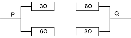

It would help to redraw the resistors conventionally as we already discussed. I have done some of that work and put in the obvious connections and labels on the left and on the right sides of the circuit. Can you complete it with only vertical and horizontal segments of connections in the middle space and then label points A and B? If so, you will see quite easily what's going on.
My method consisted of assigning current ##I## through the 3Ω resistor in which case the 6Ω resistor would draw current 2A-##I##. I then applied Kirchhoff voltage and current rules to a loop in the redrawn circuit that included these two resistors and the segment labeled AB.

That would be the case if there is nothing else beyond the parallel 3Ω and 6Ω resistors. It is certain however that if you have a ##2\text{A}## current splitting two ways and ##I## goes one way what goes the other way is what's left over, ##2\text{A} - I.## Did you complete drawing the circuit?
I tried putting H-shape wire in place of AB, but that would mean all the current would flow from left part of circuit to right part through AB, but that's not the case. Current is going from A and B to Q, not only from either A or B. But I can't draw it in any other way.
I was unable to upload the image of circuit here, so please click the link below:
https://drive.google.com/file/d/1pgqzcI1Q0Ty8VgrojdYz3_p-jBO1XR_T/view?usp=drivesdk
I seem to contradict myself, but I know this diagram is wrong.

How to find current in branch AB having no resistors but with voltage difference
Do you seriously believe that there is a voltage difference between A and B ?
If there wouldn't be voltage difference between A and B, then how would current of 0.66 A(as given in the answer) would flow from A to B? If we don't consider the answer for a moment, it is clear from the figure that the circuit is not a balanced wheatstone bridge, as 3/6 is not equal to 6/3. Then it's implied that there exists a current flow from A to B.
How does current flow through a wire? Does it require a voltage difference between one end of the wire and the other?

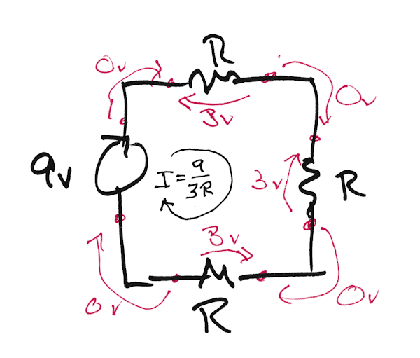

No. Not through a wire (well, and ideal wire anyway). Until you get that straight you're going to have a lot of trouble w/ circuits.
The current around a circuit requires a voltage and the current through a non-zero-ohm element requires voltage, but the current flows the same all the way around the circuit and there is no voltage drop across the wires that connect the elements.
Here's a simple example:
No voltage across the wires.
