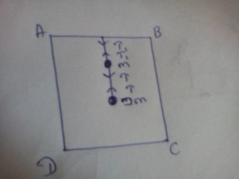

This is my problem,
ABCD is a lift.
1-- when the lift not moving i want the T and T1.
T1= 3mg
T= 2mg
Right ?
2-- when the lift is moving with accelartion a. I want to know the new T and T1.
Are they
T1 = 3m(g+a)
T = 2m(g+a)
Am i doing it right?
Please show your reasoning.
Are the masses not equal then? I don't see that on your diagram.
You should draw separate free body diagrams for each mass.
First mass is m
Second one is 2m
That looks right. Just make sure you assign the correct +/- sign to 'a'.

Yeah, thank you sir
