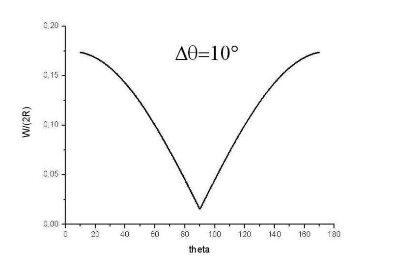

Assume angles between 0 and 90 degrees, and a given angle interval, Δθ. You need the narrowest detector at projection angles near 90 degrees. In the figure, Δθ=10°.
It is a bit more complicated if you allow angles between 0 and 180°. I will think about it.

Electrons projected at angles greater than 90° also fall to the detector area W if they are in the range between θ and θ+Δθ and 2r(sinθ-sin(θ+Δθ))=W
So you have the piecewise continuous function, see attachment.
W(θ) = 2r(sinθ-sin(θ-Δθ)) if θ≤90°
and
W(θ) = 2r(sinθ-sin(θ+Δθ)) if θ≥90°.
Electrons projected at a range Δθ fall on the smallest width W if the angle is 90°.
Or you can conclude from x=2rsinθ that the electron density along the x-axis (proportional to dθ/dx) is highest when cosθ=0, that is at x=2r: you should place the detector there.
