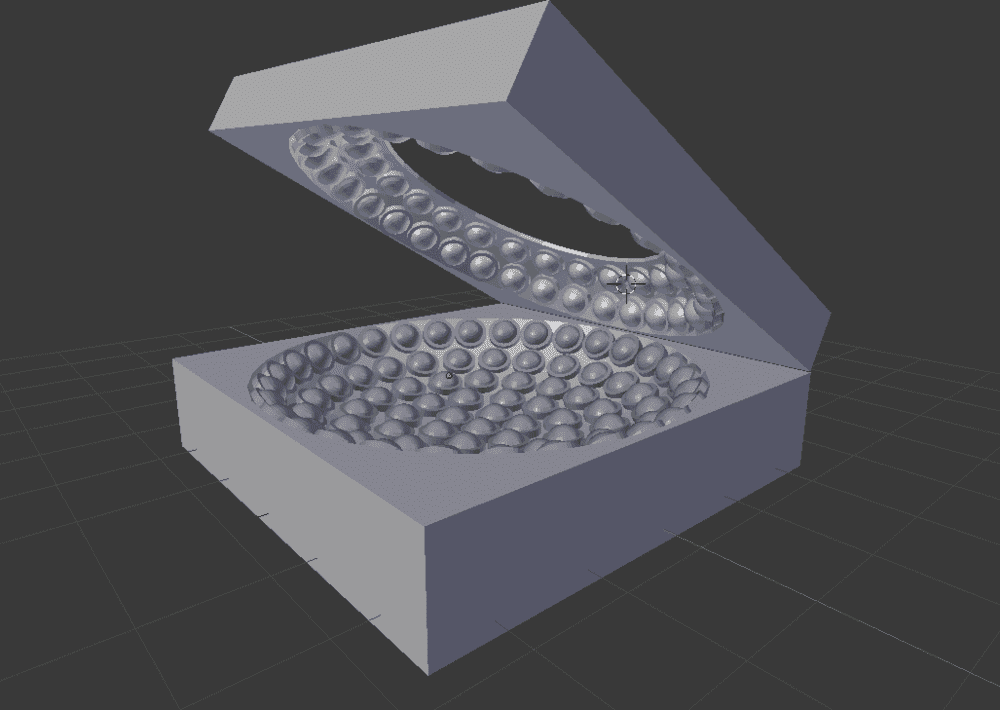

So the end goal is to have an omnidirectional non motorized treadmill of sorts. My idea is to have two half spheres lined with rollers, either ball bearing or simple rollers. One of the halves will have a portion cut out from the bottom to leave a space for the sphere.
Can you post a sketch of your planned "treadmill" assembly (at least in the region of the spheres) so we can better understand all of the elements that will affect the spheres?
245835
This is the general mockup with roller ball bearings.
It's not multiple spheres, but one large one that will set encased by the roller bearings.
Now I understand your above description. Can I assume the part of the sphere exposed thru the hole in the top is part of the running surface of the "treadmill"?

I can't upload a sketch at the moment, but I'll try to explain it as well as I can!
create something which will sit inside your stretched rubber sphere. The device would have ball bearings on the outside, which will line up with the gaps between the ball bearings of the outer shell. The top of the device will be flat, with smaller rollers to stop it from being bumpy. Wrap the sphere around it and then fit it into the outer shell. The rubber will move between the inner & outer bearings. the internal part will be held in place by the location of the outer bearings, forming 3-point holds on the inner bearings (preventing them from moving in any direction) with the rubber membrane in between. The sphere will roll around the inner, inside the outer, and with a flat top for walking on.
I'm not sure what the difference would be between an omnidirectional treadmill and your design, so far as the necessitating prediction of the users movements - both result in a flat surface which can move in any direction, so surely any requirements an Omni-treadmill has would also be required to make yours work? Otherwise you could simply have an Omni-treadmill without the motors to achieve a freely-moving omnidirectional surface?
I do see how your design would be much more compact than an Omni-treadmill, however, with many less motors etc.
Ahh that's pretty clever! The only problem I could see is the ball bearings clamping the material between each other as weight is put on top.
The other problem is, at least at the consumer level, ball bearings are pretty expensive. I was thinking about rollers, but they aren't much less expensive and I'm unsure how the friction of rollers not parallel to the movement would affect the movement.
