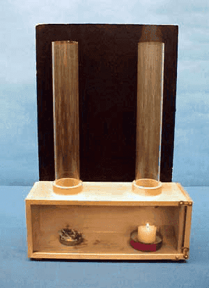

This demo (a movie) is used in most schools to show how convection works. The chimney doesn't have to be above the roof of the house but it helps a lot to overcome adverse conditions and a cold flue!
This is an example of a Heat Engine, which does work when there is a source and a sink of heart. The 'engine' does work, using the heat energy supplied by the candle.
A high chimney gives better convection BUT, as mentioned earlier, getting things going on a cold day is more of a problem.
A cowl on the top will keep rain out AND mitigate the effects of unfriendly wind. This one is 'top of the range' and helps with gas extraction when the wind blows.
