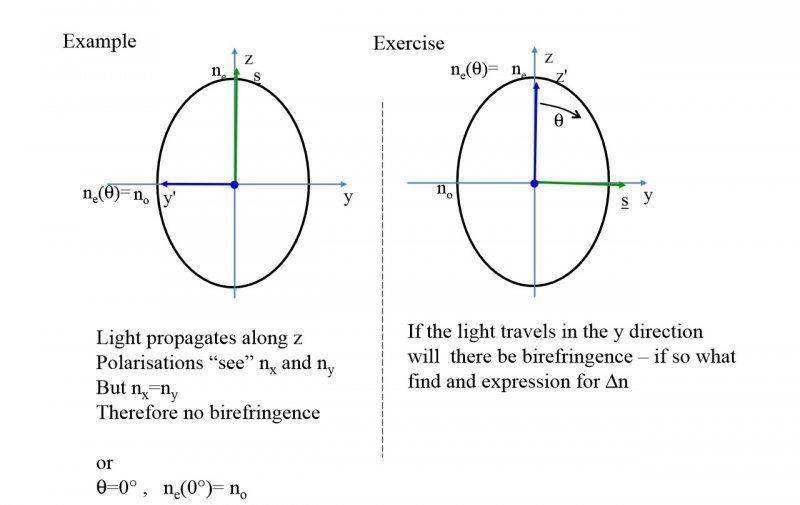

The discussion centers on the principle of birefringence, specifically focusing on the calculation of Δn, which represents the difference in refractive indices for light traveling through anisotropic materials. The participants clarify that for the given scenario, where nx = ny = no and nz = ne, birefringence occurs due to the differing refractive indices in perpendicular directions. The key takeaway is that Δn is calculated as the difference between the ordinary and extraordinary refractive indices, specifically Δn = ne - no.

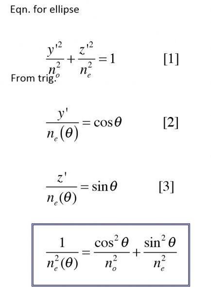

I finally understand the principle of being able to imagine light as having 2 perpendicular components of electric field, to use an analogy from an earlier thread, its just as a weight on a slope may be considered to have 2 componants.
Anyway, for this example nx = ny = no and nz = ne. Light is traveling in the y direction therefore the perpendicular E components will be subject to nx and ne i.e. there will be birefringence.
My question is the question asks for Δn and I am unsure what this means. Do I just find a term for nx - ne?
Please see attached images to visualise the problem, 1 shows the problem, 2 shows the working for a similar problem, thanks in advance.
