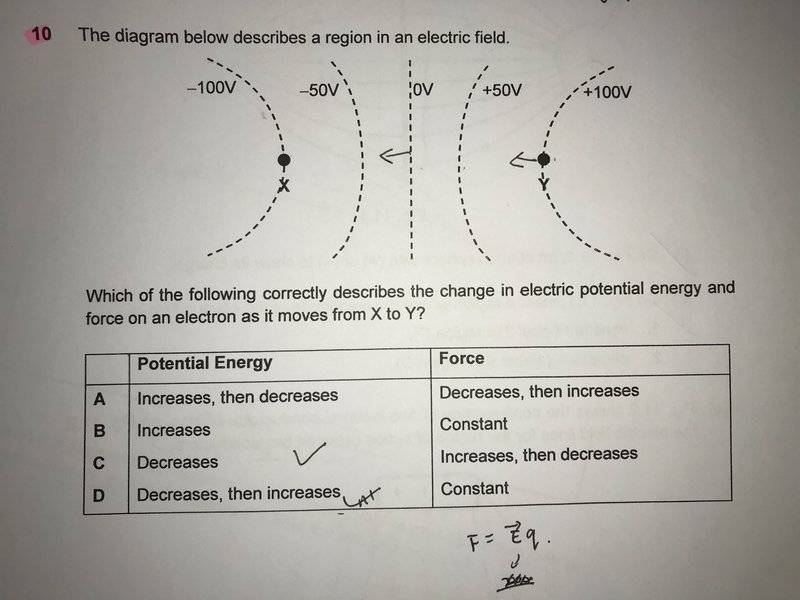

In summary, direction is not a factor when determining the change in potential energy, but it is important to consider in the case of force. The direction of movement does not affect the change in height above the ground. The force may increase and decrease due to various factors, and the strength of the field is directly related to the distance between potential lines, according to the equation E=-dV/dx. Closer field lines indicate a stronger field.

Why do we not need to consider direction when determining the change in potential energy? Why do we need to consider it in case of force? Or am I interpreting the question correctly?
Does it matter if you move stairs up or down if you are asked about your change in height above the ground?
Same thing here.
Likes Angela Liang and sophiecentaur
Thanks! But why does the force increase and then decrease?
What is the relation between the field strength and the distance between the potential lines (in 50 V steps)?
E=-dV/dx right?
Angela Liang said:
E=-dV/dx right?
Oh yea I got what you mean. Closer field lines means stronger field. Thanks!
