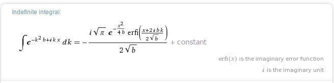

Okay so I was integrating an expression and ended up getting an imaginary error function in the answer. I'm not sure where to go from there, I plugged it into wolfram and the root it gave me looks nice but is that worth anything to me?
The integral was being evaluated from -∞ to ∞, would I need to evaluate the error function from these limits or is the root what I'm looking for?
Here is the original integral and resulting error function
If you want the infinite integral a better approach is to complete the square (in k) of the exponent. net result is I = e^{\frac{-x^2}{4b}}\sqrt{\frac{\pi}{b}}.
Comment: All you are doing is taking the Fourier transform of a normal curve.
Okay that makes sense. Thanks!
