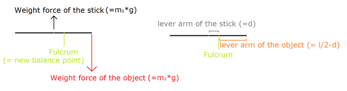

I'm still not quite sure about it, but maybe I found my problem. Correct me if I'm wrong:
- The fulcrum and balance point, aka the fulcrum and the center of mass of the stick, are in the same place when the system is isolated, i.e. before putting the item on the end of the stick. They are both in the middle of the stick. However, they are not the same thing, they just happen to be in the same place. As a matter of fact...
- ...after placing the object at one end of the stick, the fulcrum moves by a distance d, but the center of mass of the stick is still in its original position, that is to say it's still in the middle of the stick.
Small problem here: I thought the balance point and the center of mass were supposedly synonyms, but if what I just wrote is correct then fulcrum and balance point should be synonyms, while center of mass is not. Semantics...anyway, correct me if I'm wrong.
Therefore, if we draw the system it should look something like the following picture (the size of the vector arrows is random, but that's not the point):
In this case, the result would be correct. Is this it?
Earlier I had thought that when the fulcrum moved, so did the balance point (obviously), but so did the center of mass as well. So, earlier, I thought that the weight force of the stick should have been represented not in the middle of the stick, but in correspondence with the new Fulcrum. Therefore, according to this process, the lever arm would have been =0, and could have only been =d if the fulcrum was still considered in the middle of the stick.
So, was that my mistake? Is the center of mass of the stick always the same, regardless of whatever external influence there may be on the object? Do we always consider the weight force of the stick in correspondence of its original (the one, the only) center of mass, in the middle of the stick? If that's the case, my only doubt left is about "fulcrum", "balance point", and "center of mass": right now I'm thinking that fulcrum is (always) the same as the balance point (so they are synonym, I can use one term to indicate the other), whereas the center of mass is not synonym with either fulcrum or balance point.

When it's just the stick being considered, the balance point and the center of mass (c.o.m.) are both in the same place, i.e., the middle of the stick, or L/2 from one end.
Customarily, the weight force of all objects is normally drawn with the arrow pointing down, i.e., towards the center of the earth. At the fulcrum point, a separate arrow would be drawn pointing upwards, and this arrow at the fulcrum represents the normal force acting to support the stick and whatever additional masses are attached to it or supported by it.
This entire drawing, shown isolated, is called a free body diagram, and it is very important in analyzing many different types of static equilibrium problems.
Remember, the fulcrum moved only because additional masses were placed on the stick. The center of mass of the stick is an intrinsic property of the stick, and it will change location only if something about the stick changes, in this case, either the mass, or the length, or both, of the stick. If the stick itself doesn't change, then neither will its center of mass location.
See above for a comment about the center of mass of the stick.
The fulcrum serves as the balance point for the mass of the stick PLUS and additional non-stick masses which may be attached. The fulcrum will move according to how all of these various masses are distributed along the length of the stick. While the stick has its own center of mass location when it is considered by itself (i.e., at L/2 from one end), the fulcrum shows us where the center of mass of the stick plus all of the other attached masses is located.

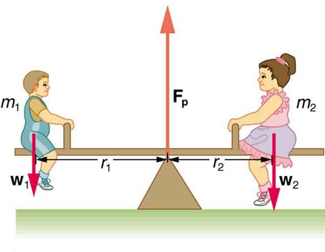

Since you mentioned it, I might as well ask this too: what is that arrow pointing upwards, exactly? I know that the one for the object should point downward, and yes, the weight force of the stick should point downward too. You said "this arrow at the fulcrum represents the normal force acting to support the stick and whatever additional masses are attached to it or supported by it.".

A free body diagram shows all of the forces and torques (couples) acting on a body. The fulcrum is replaced, in this instance, by a force equivalent to the weight of the stick and any masses attached to the stick.
The image of two kids playing on a seesaw should illustrate this concept:
seesaw.jpe
Here, Fp = W1 + W2 + weight of the seesaw

1.) Yes. Instead of "intensity", the preferred term is "magnitude".
2.) The direction of motion which is likely to occur due to the forces acting on the stick will depend on the location of the fulcrum point with respect to the location of each mass.
NOTE: In the diagram above on the left, the force m1 * g should actually be drawn pointing down according to convention.
The torque created by m1 tends to rotate the stick CCW because of how it is placed w.r.t. the fulcrum, while m2 tends to rotate the stick CW. If the fulcrum is placed properly between m1 and m2, then the net torque tending to rotate the stick will equal zero, and the stick is then balanced.

Yes. Static equilibrium is actually a two-part condition:
1.) The sum of all forces acting on the free body = 0.
2.) The sum of all torques acting on the free body = 0.
The usual concept is to think of a force as a vector, which has a magnitude (your "intensity") combined with a direction. A torque can be modeled in a similar manner, where its magnitude is the product F * d (or equivalently, m * g * d), and its direction is the manner in which the body wants to rotate in response to the presence of the torque.
