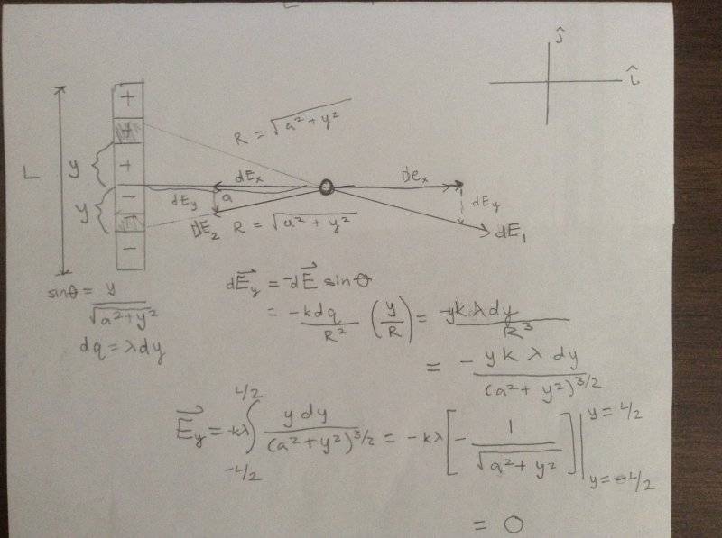

(Just for number 1 only - finding electric field) [/B]

dE = k dq/R^2
sin theta = y/R = y / sqrt (a^2 + y^2)
dq= lamda*dy
[/B]
I'm confused at the point of calculating the integral from -L/2 to L/2. I got the final integral solution from the "Special integrals table". Are my steps correct for the problem?...for some reason I keep getting zero for my answer and it just doesn't seem correct. Thank you!
Handwritten diagram of a uniformly charged wire of length L split into segments with alternating + and - signs, showing field contributions dE1 and dE2 at a point a away, with R = sqrt(a^2 + y^2), sin theta = y/sqrt(a^2 + y^2), dq = lambda dy, and the integral of dEy from -L/2 to L/2 evaluated to zero.
Where in your calculation do you account for the difference in sign of the charge elements above and below the x-axis?
gneill said:
Where in your calculation do you account for the difference in sign of the charge elements above and below he x-axis?
Well I know that the point charge has a small dE towards the negative side of the wire while the positive side repels from the charge. Breaking it into component forms of both dE experienced by the point charge, I realized that the dEx would simply cancel each other out. From there I just took the integral of dEy. Was this wrong?
How would your result for the y-component integration differ from that for a line of charge that was all positive? What distinguishes your integral from that one?
If the wire WAS all positive, then in that case the y component would cancel out resulting in both x components of the dE in the positive x direction. From that only one integration was done to find a small section of dy. Are you implying that I have to add the integral of both dEs of the y-components?
So ∫(from 0 to L/2) dE1 + ∫(from -L/2 to 0) dE2 ?
Yes. You have to split the integral because of the change in sign of the charge elements. This applies to the summation of the y components. Otherwise you're treating them as all due to positive charges only, and by symmetry the y-components from the top half would cancel the y-components from the bottom half.

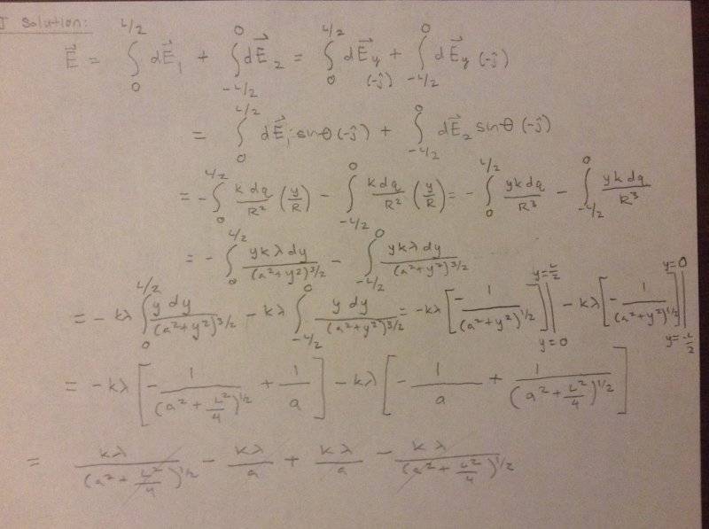

Sorry to bother you again...so I did the integration this time with the different limits but still got an answer of zero. Could this possibly be due to my R- afterall they are the same for both Ey1 and Ey2...
Handwritten derivation of the electric field from a uniformly charged wire, split into two integrals over y from 0 to L/2 and from -L/2 to 0, with the y-components summed and simplified to a final expression in k, lambda, a and L.
Usually these sorts of issues are related to sign changes that are tied to the direction of integration: the order of the integration limits versus the sign of the differential element (dy in this case) and that of the variable being integrated. It can be tricky to untangle at times.
It may be expedient to do the integral for half the wire (say the positive half), check the sign of the result versus what you expect from your diagram, then invoke symmetry to declare that second integral returns the same result.

So you're saying in this case it's best to "assume" that both dE are the same and by symmetric have E= 2 ∫(from 0 to L/2) for dE1 ? Hate me for this, but I'm a little confused on what you're inferring :/ if that's the case, the result from it is -2k*lamda[-1/ sqrt((a)^2 + (L^2)/4) + 1/a ].
You want to check the integrals table. I miss a factor y in the numerator.
[edit] Sorry, wrong component. o:)
You can check your result -2k*lamda[-1/ sqrt((a)^2 + (L^2)/4) + 1/a ] here .
Your q is ##\ {\lambda L\over 2}\ ## , your d is ##\ {L\over 2}\ ## so your ##\ p = {\lambda L^2\over 4}##
With ##\ {1\over\sqrt{1+({L\over 2a})^2} }\approx 1 - {L^2\over 8 a^2}\ ## you should get the ##\ E = {kp\over a^3} \ ## (and I think you do).

Our professor hasn't covered electric dipole potential yet so I don't think that will be useful to me. My main concern is to why we have to 2*∫(from 0 to L/2) for the dE of the positive side when they aren't really symmetric in terms of the dE of the negative.

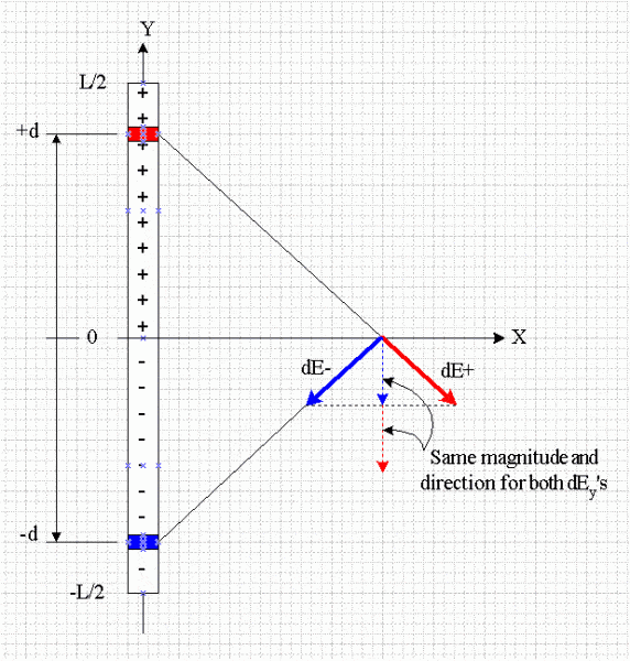

You can demonstrate the symmetry geometrically on your diagram by selecting suitable representative charge elements from both ends of the charge distribution and showing that their contributions to E in the y-direction are equal and in the same direction.
Diagram of a uniformly charged vertical line of length L from -L/2 to L/2 on the y-axis, with a red element at +d and a blue element at -d, each sending a field vector dE+ or dE- to a point on the x-axis; their y-components are marked as equal and in the same direction.
This fact alone allows you to reduce your work to a single integral over a portion of the diagram where the signs of things are straightforward to deal with: from 0 the L/2.
Note how the positive charge elements are making contributions in the negative y direction, so you need to be careful about handling the signs of your sin() expressions if you choose to perform both integrations separately.
Ah I see, makes a little more sense now :smile:...so since both the dEs are going in the negative y direction with the same magnitudes, its safe to say that the positive side & negative side of the wire can be found through integration by symmetry. Thank you for the visual! Just a curious thought though...when would it be the case to "integrate separately"? I feel like with a linear wire, at least one of the component cancels each other out and symmetry seems to be always applicable.
