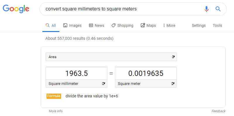

Ok so you did convert from square mm to square m but in the proper way , I used an online converter.

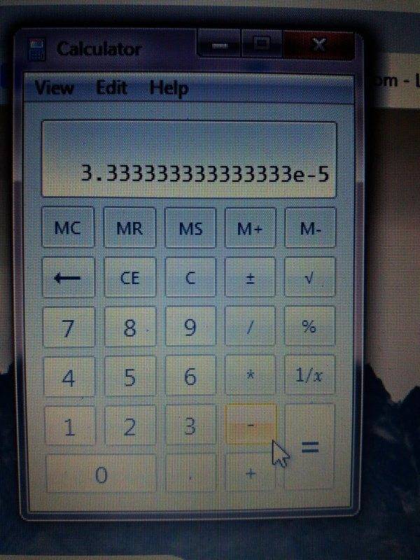

  • #52
I always stop to something when I try to make a sum , this time I have this to make me confuse , same exactly sum but different calculators different results .
  • #53
That's the same result, just written in a different format. The e-5 at the end of the first number is a standard computer and calculator way of writing ##×10^{-5}##. So that number is ##3.333×10^{-5}##, which is ##3.333×\frac 1{10^5}## or ##3.333×\frac 1{100,000}## or 0.00003333, which is what the other calculator says.

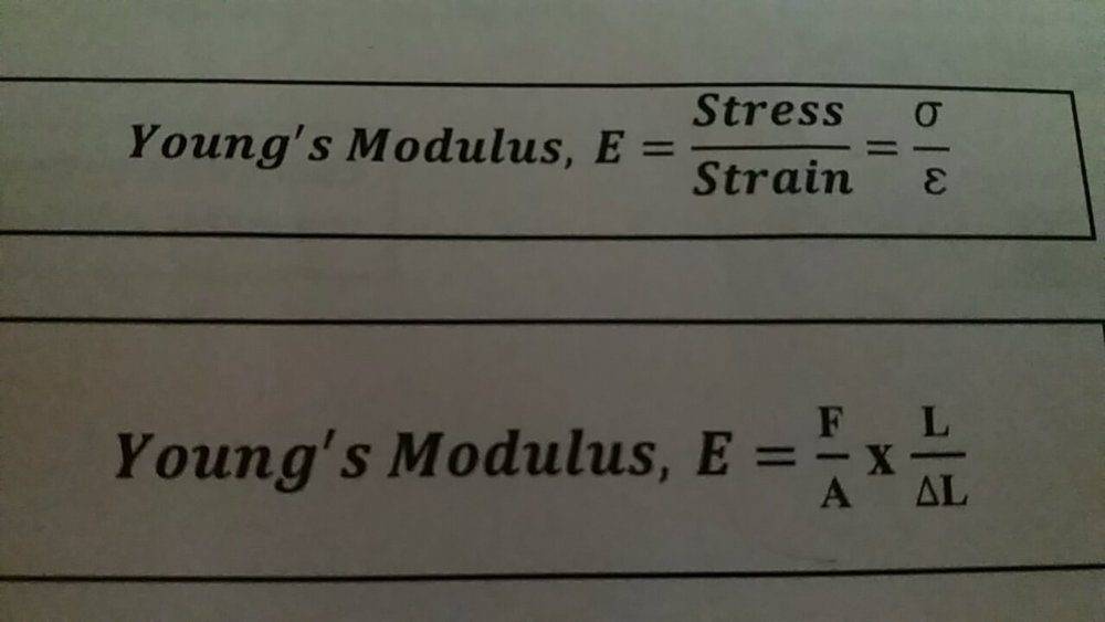

And it keeps going with strange things, last question is to find the young modulus , in the notes if found this to confuse me , E is equal to two different formulas
  • #58
Use the one for which you have the required variables.
  • #59
Note that the ##x## in the second formula should be the multiplication symbol ×.
Stress is force over area. Strain is length change over original length. The second formula is what you get when you substitute those definitions into the first formula.
Online converters work. Just have to use the right units. I Googled "convert square millimeters to square meters". Without leaving the Google page, a converter was displayed. I keyed in 1963.5.
