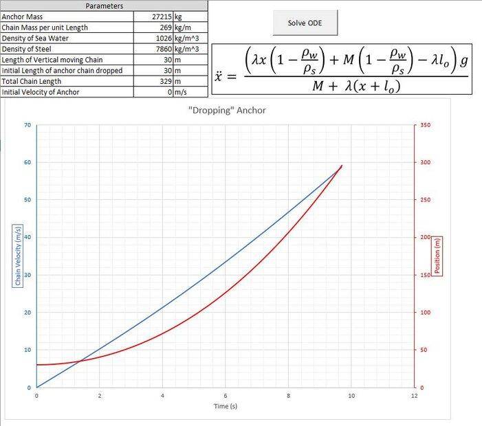

I get the following equation of motion, for what seems like would be worst case scenario...complete primary brake failure.
$$ \lambda \left( x+ l_o\right) \ddot x = \lambda g \left( x-l_o \right) - \beta { \dot x}^2 $$
Where:
##\lambda## is the chains mass per unit length
## l_o## is the length of chain suspended on the back of the capstan
## \beta## is the total drag coefficient
## \downarrow^+ x## is the length of hanging anchor
If I had the figures, I could try to solve for the projected area of the sea anchor, and force on it required to limit its velocity to some threshold.
I know you said they can start after the anchor has landed too, but how often is that the case when it is a controlled decent? If its uncontrolled, and the anchor hits bottom while the chain is carrying a lot of momentum, then the "sea anchor" doesn't help, but if the sea anchor always provides some level of controlled decent is it likely to happen?
EDIT: This model isn't quite correct either. I think there is supposed to be a linear ##\dot x## term in there as well. I remember having a conversation in PF before about the solution being somewhere between Work/Energy and Impulse/Momentum for the rising chain (on the back of the capstan) which is accelerating the links in the pile from rest...I didn't account for that
EDIT: Maybe its ok after all. That was a slightly different problem where the length of the chain rising was increasing. This problem the length of the chain rising is constant.

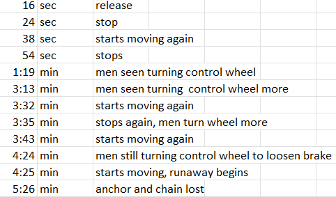

This video is better. The capstan wheel is visible. The chain stops several times. The men on the brake are seen turning the wheel to loosen the brake for minutes. Finally, runaway begins. Here are significant events in the video.
There is so much dust in the air, that the men can not be seen trying to tighten the brake after runaway begins. However, I think they may need to turn that wheel the other direction for 3 to 4 minutes before the brake starts braking again. But the chain is lost in less than 1 minute.
I also found some data from the USS Nimitz. I'm going to try to estimate chain velocity from the videos, and then calculate braking power needed to prevent a runaway.

I haven't looked at all of the videos. but the several that I did see have 1 thing in common:
Operator error. When the chain stops due (presumably) to the anchor reaching bottom, they continue to back off the brake. When motion resumes, they are backed-off so far that they don't have a prayer of catching up. There isn't anything wrong with the equipment - it just isn't designed to recover from a situation that never should have occurred.
This seems like an idiot-proofing exercise.

Here is what I get for the chain velocity in the absence of drag, either from the capstan or fluid drag. The velocity is almost linear in time.
I don't know if this is of interest anymore, but there it is.

I tried to find a 1.5 MW water brake on alibaba.com, but I find nothing similar. Perhaps I'm using the wrong search terms.
@erobz, @jrmichler , I'm not a M.E. Do my calculations appear correct?

I think you need to consider the mass of the anchor as well? Also the final mass of the chain will be the initial hanging mass + the anchor+ the additional 30 m of chain at 5 m/s. You also have to change the kinetic energy of the mass that is traveling vertically inside the ship.
I'm assuming that the runaway begins after the anchor touches bottom. Also assume that as soon as chain speed exceeds ship speed, the chain becomes nearly vertical, and the length of chain in motion remains constant.. But yes, I should include the K.E. of the ascending chain also; that would need about 50% more power.
Sorry to hear you're not well. Get well soon.
So the anchor is on the bottom, but the chain hangs close to 30 m before it touches water correct?
