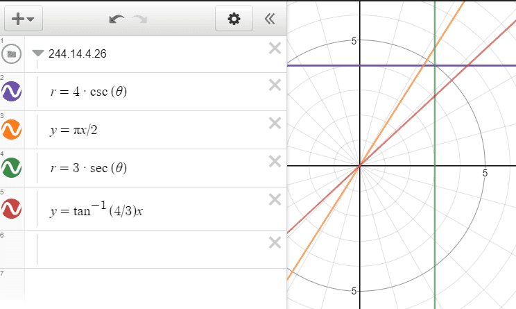

OK first I don't how you plot $r^7$ on Desmos

Can you plot:
1) [tex]\theta = \tan^{-1}(4/3)[/tex]
2) [tex]r = 3\cdot\sec(\theta)[/tex]
3) [tex]\theta = \pi/2[/tex]
4) [tex]r = 4\cdot\csc(\theta)[/tex]
Why are you trying to plot $r^7$? $r^6$ may be more appropriate. Why?
  • Desmos graphing screenshot with a folder labelled 244.14.4.26 listing r = 4 csc(θ), y = πx/2, r = 3 sec(θ) and y = tan⁻¹(4/3)x, plotted on a polar grid with rings marked 5.
Interesting. Why did you choose to abandon $\theta$ and insert y and x on $\theta = \pi/2$ and the inverse tangent?
$\theta = \pi/2$ is the y-axis.
Give some thought to the inverse tangent, too.
You could just substitute some version of the basic identities and rearrange a little.
$y = r\cdot\sin(\theta)$
$x = r\cdot\cos(\theta)$
$r^{2} = x^{2}+y^{2}$
$\theta = $ ?? I'll let you track down this one. :-)
$\theta = \tan^{-1}(4/3)$ doesn't plot
I assume we are finding the area of a wedge?

Are you sure you're understanding the problem statement? I don't see any instruction to EVALUATE the integrals. Just draw the pictures and transform to Cartesian Coordinates.
I don't don't think my drawing is correct?
or is it?
or is it?
You haven't fixed $\theta = \pi/2$
that expression won't plot in desmos
is the same as $x=\frac{\pi}{2}$?
Absolutely not.
