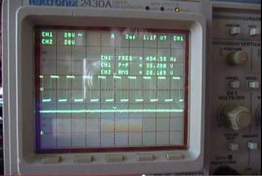

what is an alternators typical V before the rectifier (IDK) ?
a sinewave clipped at Vout + a couple diode dropsfound this on youtube
a fellow running one at ~30 volts for a HHO generator
as you can see it's capable of substantially more voltage, how high would the peak be ?

you'll want a higher voltage rectifier pack
the stator iron will get hot at that flux level and frequency
and you'll not get full 90 amp output current
you'll have to experiment
