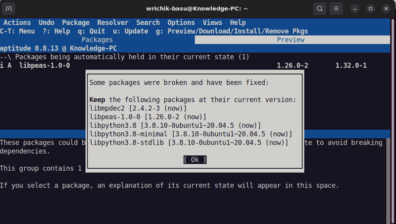

Did the upgrade. All applications were working fine. But then, I screwed up pretty much everything.
After the upgrade, there was no gnome-control-center (aka Settings). I tried to do sudo apt install gnome-control-center and got the following error:
Bash:
Reading package lists... Done
Building dependency tree... Done
Reading state information... Done
Some packages could not be installed. This may mean that you have
requested an impossible situation or if you are using the unstable
distribution that some required packages have not yet been created
or been moved out of Incoming.
The following information may help to resolve the situation:
The following packages have unmet dependencies.
 libpython3.10 : Depends: libpython3.10-stdlib (= 3.10.4-3ubuntu0.1) but 3.10.6-1+focal1 is to be installed
E: Unable to correct problems, you have held broken packages.

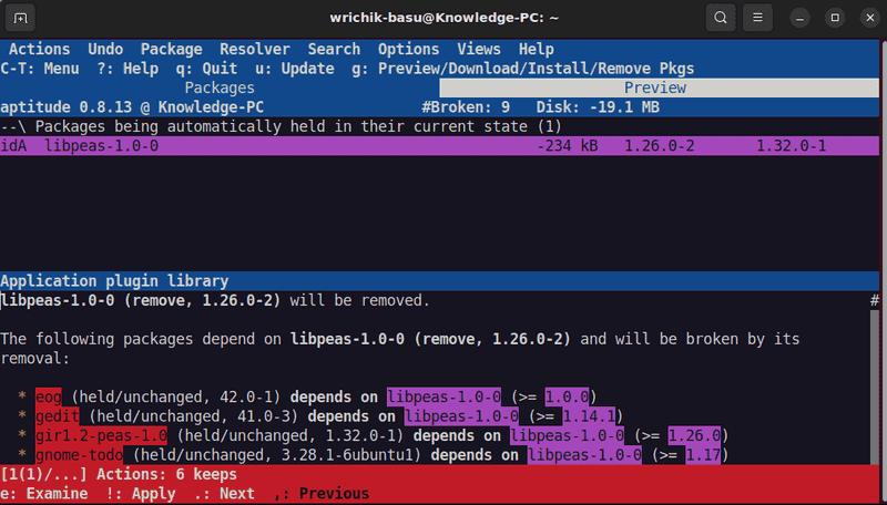

I tried sudo apt --fix-broken install, sudo apt upgrade and sudo aptitude safe-upgrade, but in vain.

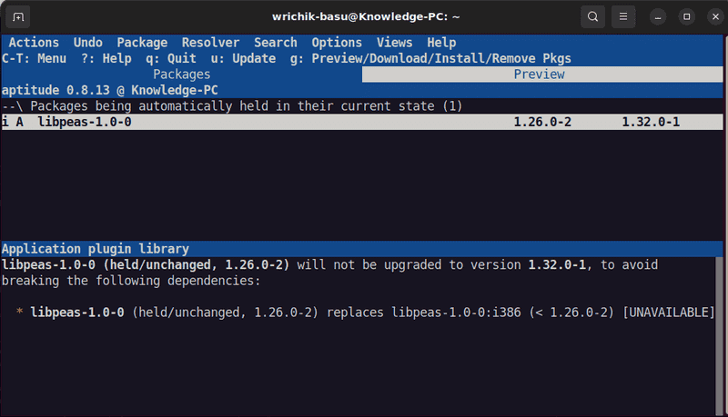

I opened aptitude by sudo aptitude. Under "Upgradable packages", there was 1 package. When I pressed g on that, I got the following screen:
I clicked on "OK" and then scrolled down to libpeas-1.0-0 to find:
When I clicked on -, I got the following warning:
Which showed that important packages will be removed if I proceed.
Here, I made the mistake: I clicked g and the library got removed, and with it, a number of packages like gedit, rythmbox were gone. But the dependency conflict wasn't solved.
I could have installed those packages back if the dependency conflict was re-solved later. But I panicked and closed the terminal and lost all the output.
TimeShift was the only way out. Restored the snapshot and got back my old Ubuntu 20.04 at the exact point where I left it. Phew.
Now the question: why was there this conflict with Python 3.10? While I was still in Ubuntu 22.04, I posted this question in AskUbuntu, and someone commented that probably packages were installed from a non-Ubuntu source. In 20.04, I had installed Python 3.10 using the deadsnakes ppa. Could that be causing the issue?
Advice from everyone is appreciated because I would have to do the upgrade sooner or later. Also pinging @pbuk who has helped me in the past in these situations.
Very likely. Once you accept a 3rd party ppa you are overriding the abilty of the Ubuntu upgrade to control what is going on.
