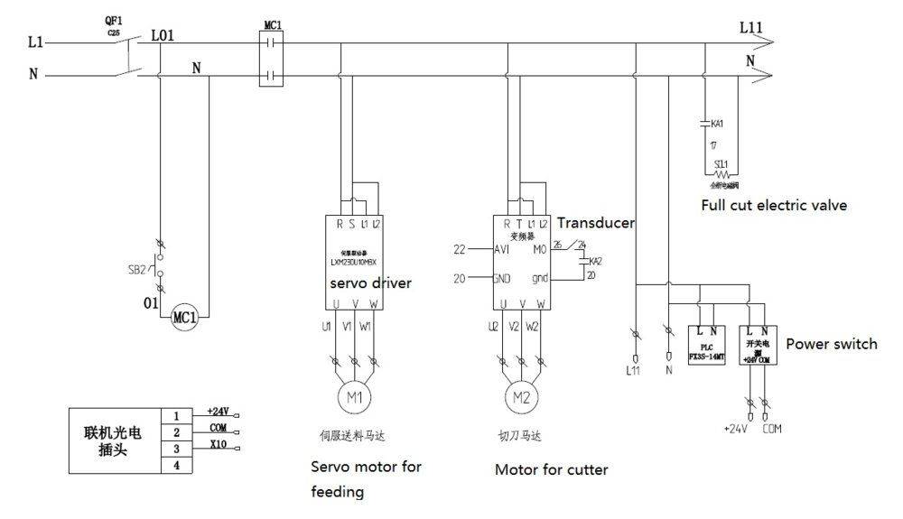

@Guineafowl I get that everyone has told me how to hook up a machine that is manufactured for the US power grid. Except my manufacture is telling me this is wrong. So my line of questions is to educate myself so that I am confident that they are one in the same.
@Asymptotic Attached is the schematic they provided.

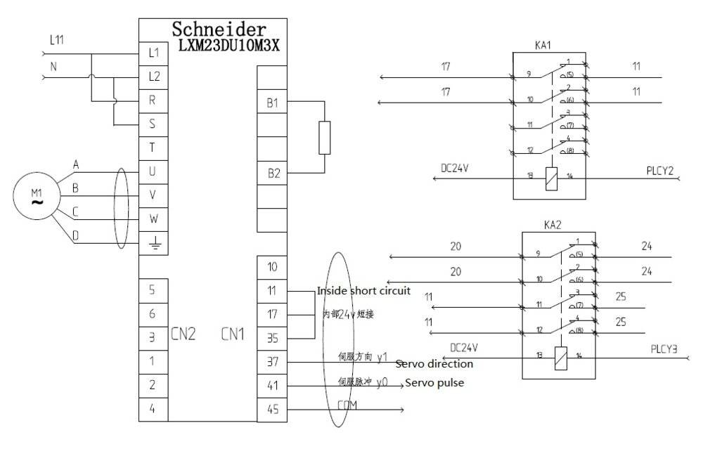

The servo drive for motor M1 is a Schneider Electric model LXM23DU10M3X.
https://www.schneider-electric.com/...s&filter=product_parent_category_id-166406748
The input voltage specification for it when wired for single phase is 220 V nominal with a range from 200V to 255V. It can't be wired for 120V operation.
On the print, the drive is connected to "L1" and "N". In this case, "N" isn't neutral - the center tap on a 230V transformer in a US split single phase system - but is rather the other hot lead "L2".

ok, but this device is designed to operate with the US grid 220v per the spec. So for the input to actually be 220v, you would need to have both L1 and L2 connected, AND a neutral? because just L1 and Neutral would only be 120v?
You’re absolutely right to check and double-check.
References to the machine “needing a dedicated neutral” aren’t quite accurate and may be something to do with translation. Perhaps they want to be sure you don’t involve the US centre-tap neutral in anything.
No, just L1 and L2. Leave the neutral out.
What the manufacturer's print shows as "N" isn't neutral. It is "L2".
Nothing on these prints use 120V so far as I can see.
