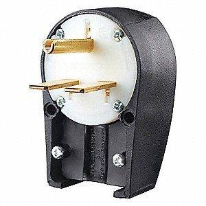

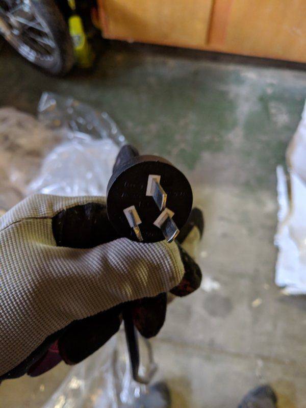

The plug on the machine has three prongs. 1 hot, 1 return, 1 neutral.
Does it look like this NEMA 6-30P? If so, it has two ungrounded line conductors (blades), and a safety ground (pin).
Black and white photo of a NEMA-style two-blade plug with a round ground pin, the two flat blades angled and the cylindrical ground pin at the top, mounted on a black plastic housing.
Can you post an electrical schematic of your machine (at least, the 'elementary' drawing showing power connections) so we can see what you have?

@berkeman The machine is grounded to the frame. The hot and the neural wires are connected to the power bus accordingly. Per the factory, one plug is expecting to be hot, 1 is neutral(return), 1 is ground.
@Asymptotic while typical 240v US wiring is technically called single phase, in reality its 2 phase. If you were to hook a o-scope up to the two wires and display them on the same screen, you would see two sign waves that are 180deg out of phase. If you probe 3 phase power you will see three sign waves that are each 120deg out of phase. I am not sure logically how else you could create a 2 phase system other than 180deg out of phase.
The people that determine the naming conventions in this country for electricians to use are also the reason that I have a machine that runs on 220v. In the USA we say 110 and 220 but its actually 120 and 240...syntax be what it may.
See attachment for the plug configuration. I believe this is a Chinese standard?

The plug you have is an ungrounded "crowsfoot", and by it's size is probably the smaller amp rated one (NEMA 10-20R is 125/250V, 20 amp, while the larger one, NEMA 10-50R, is 125/250V, 50A). These are depreciated connector types, and while legit in grandfathered applications, have been against NEC code since 1999 to use in new installations since they don't have a separate safety ground pin.
On these, the X and Y terminals (angled blades) are connected to L1 and L2, and W terminal (straight blade) is connected to neutral and equipment frame ground. This is problematic from a safety perspective, and why it has fallen out of favor.

The Chinese three pin plug is the same as the Australian. Equipment is designed to remain safe even when the active and neutral are swapped. Either way, RCDs will detect the active-neutral imbalance that results due to any ground leakage.
Chinese 230V ±10% equipment will work on the US split single phase 240V system. Just make sure you connect the Earth if it is present.

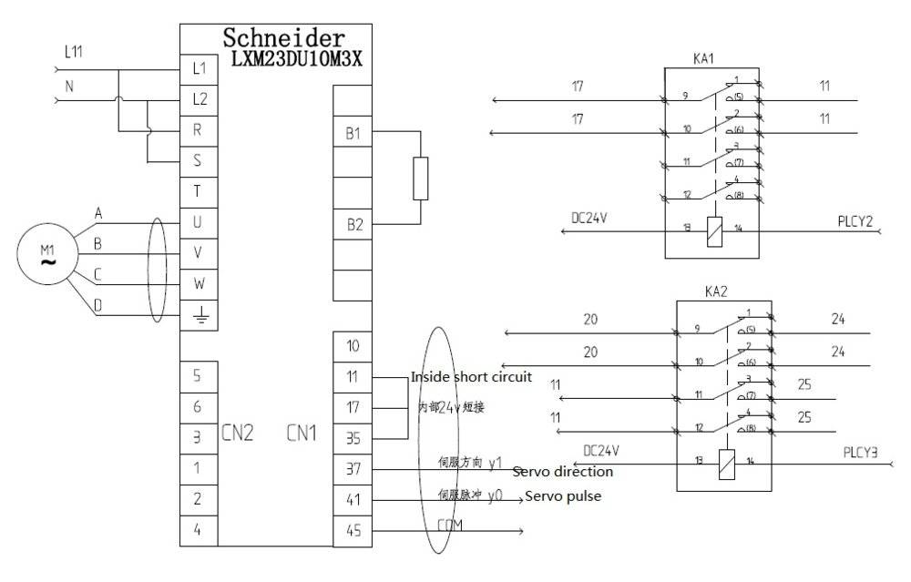

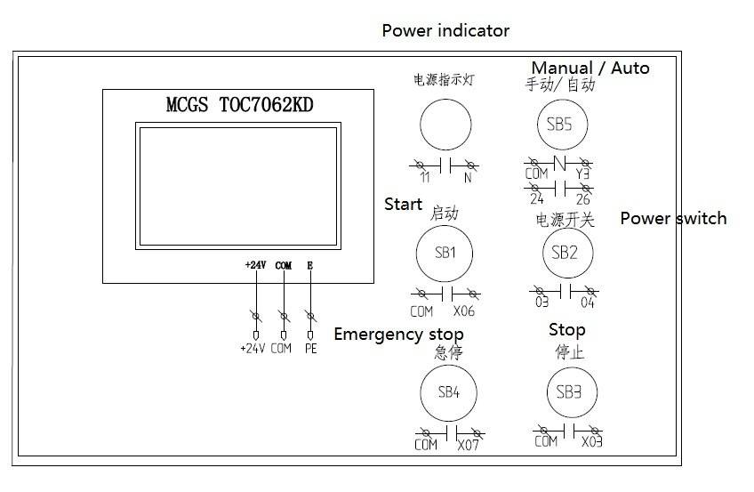

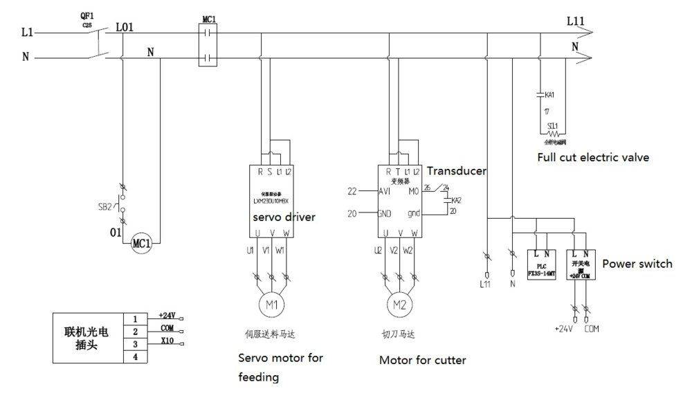

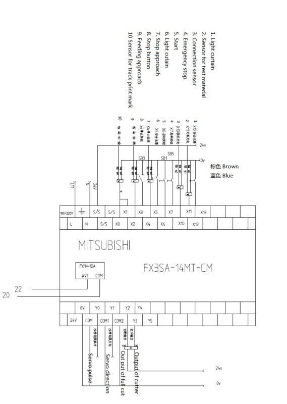

If I had a schematic I would gladly post it. China custom built's do not come with this luxury. The instruction manual is computer print outs.
3 Things.
1) Per the manufacture, the machine is wired to have a 220v hot, a null(in my above statements, this is synonymous with neutral/return), and a ground. It requires a neutral and a ground. Within the machine, the Neutral leads of the onboard electronics are not tied to ground(the frame), they are tied to the neutral connector. If I connect the neutral lead of the machine to L1 or L2 of the transformer, this would be "cramming" 120v up the neutral "return".
2) The machine is custom made. It is not designed to operate with the US power configuration.
3) Their is not schematic. Their is no manufacture website. This is not a GE product. What I have to go on is what I get from talking to the manufacture. "DO NOT CONNECT 120v potential to the Neutral. The machine requires a dedicated neutral". Is the manufacture wrong? I badgered the english speaking sales staff for days until they promised me they talked to the design engineer(only speaks chinese) to confirm this statement.
This machine was not built to a particular countries power spec. It was built as requested by the electrician that I brought with me to china when the machine design was being hashed out. The wiring configuration of US power 220v was never conveyed to the manufacture. The need to have single phase 220v was. So the manufacture built a machine around the expectation that 220v would be present on one lead, the next lead would be neutral, and the 3rd lead would be ground. The power bus has two lead from the plug with one as neutral, one and hot(240v) and the ground is tied to the machine frame.
My question is not about NEC code. Its about how to power this machine without blowing it up. If I hook up the machine with L1 and L2 across the hot and neutral line of its internal power bus this would be in direct conflict of what the manufacture is telling me to do. I understand that this is code and that every single machine that is built and sold retail in the USA meets this requirement. But unfortunately this is not the domain I am operating in. To follow the US wiring standard would be in direct conflict with the manufactures specifications.

dabnug said:
This is the puzzle I am trying to solve.
You’ve got three or four posters up there who have given the same answer. You seem to be stuck on the idea that neutral is somehow ‘passive’ in the power circuit, which it is not. It sinks and sources current just as much as the phase.
If you insist on a set-up from 120V, you’d need to ensure the output was fully floating, then bond an Earth wire to one output, take this to an Earth stake, then carry that forward as the earth. The bonded output would then become neutral. The other output, phase/hot. Any safety breakers and RCDs/GFCIs would need to be on the output side of the transformer. You would be, in effect, making your own mini domestic supply. Totally unnecessary and not recommended.
In the Chinese/EU set-up, the neutral has 240V ‘crammed’ up it relative to the phase every half-cycle.

Let's go at this from the motor perspective.
  1. Are these motors rated for a single voltage (230), or can they be wired for either 115 or 230V operation?
  2. If the latter, open a motor conduit box and verify for what voltage it is wired, 115V or 230V.
Follow a pair of motor power leads back to the supply plug. If the motors are wired for 230V, and they are connected eventually (through whatever control elements that may exist; switch contacts, relay contacts, and so on) to the plug 'X' and 'Y' poles, then the supply voltage is 230V. If the motors are wired for 115V, then the supply voltage between 'X' and 'Y' poles on the plug was intended to be 115V.
dabnug said:
The power requirements are 220v single phase with 4 motors that draw about 16A collectively.
Based on this I'm suspecting the former is true.
If so, the only thing 120V might be used for are control system components. Are there any 120V rated devices (relay coils, displays, etc) in the control system?

Here’s the thing:
1. You asked how to hook the machine up, and most of us have told you to hook up as per usual US 240V. You don’t seem to like this answer, in part because you are confused about what live/hot/active and neutral actually mean.
2. It seems you prefer the option of a step-up transformer from US 120V to 240V.
*** The output of the transformer will be isolated from the input. Therefore, you’ll feed in a hot and neutral at 120V, and get out 240V with neither hot nor neutral, but two isolated AC terminals. You’ll still not have a neutral. ***
There is no sensible way of obtaining a neutral like a Chinese/EU system in your country, without shinning up a power pole. Nor is there a need to. Go with option 1, or get an electrician in.
