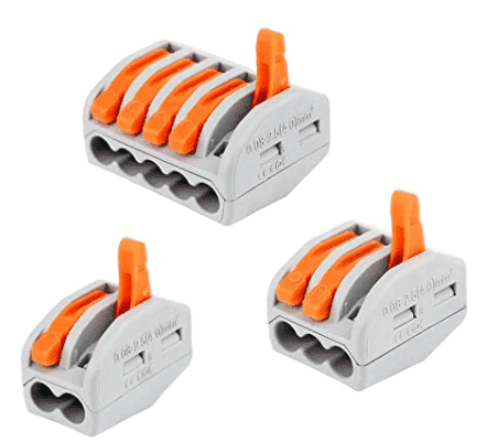

Connectors like these can replace wire nuts inside boxes. They are mostly used outside the USA, but they might be allowed by US electrical codes. I'm not sure.
I frequently use those "Wago" connectors and prefer them to wire nuts. However, judging by the exterior junction boxes I've seen, terminal strips make for more organized layout.
