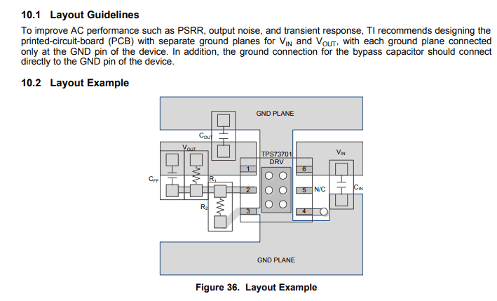

Hi Jim, hopefully, the layout is not too messed up. I have ground plane polygons on the internal layers. They make about 70-80% of the surface area of layers 2 and 3. I think a large inductor or maybe 2 inductors on 5V and GND lines could help to reduce the noise. I am not sure about the values of inductors to use. The load current is about 350mA.
Thank you

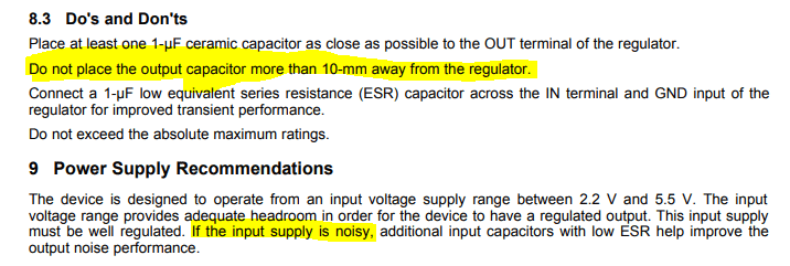

jim hardy said:
just fishing...
from TI datasheetView attachment 230012
View attachment 230013to your question about an inductor
even a ferrite bead would help.
Dont obsess about its stray capacitance, your 10μf should swamp it. I'd worry more about Z of that single via..

Hi Jim, I am going to order a demo board for the TPS73701DCQR, TPS73701DRVEVM-529, to verify my layout. If the output from the demo board is not noisy, then I have a layout issue.

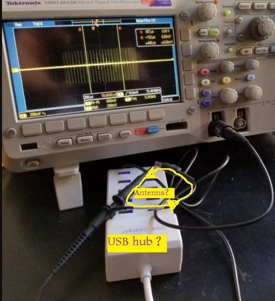

chakr said:
Noise is fun to deal with.
I don't think you can get a good measurement anyplace near that USB hub.
You did the experiment i was hoping you would
that thing is radiating so intensely it induces voltage in your 'scope probe. A few feet of separation might help.
I'd say try powering your gizmo from a battery if you can find one that's not over the 6 volt absolute maximum rating and preferably not over the 5.5 recommended maximum operating.
Maybe series up three AA's ?
If that helps get a 4.5 or so volt "Wall Wart" that's linear (line frequency transformer and rectifier inside) . You can tell them from switchers they're about twice as heavy. Thrift shops are full of them .
First you might try placing a copper clad iron skillet over the USB hub for an EMI shield. That ought to be nice and lossy at 100 khz
Keep on having fun ! It feels so good when you conquer a pesky problem like this.
old jim

chakr said:
The noise generated inside the hub affects circuits inside.
Well, on the picture you have attached previously that terrible thing on the screen of your 'scope is picked up through a classic one-turn loop? ...
... to be honest, your circuit with that LDO looks 'good enough' for most application. Of course, it is not able to make up for excess mistreat, that would require more circuits added.
If you are interested in your hub then maybe you should dissect that instead? (I'm too interested. Slightly.)
But my practical side keeps saying that you should just dispose of it.
Ps.: just one important remark. That's no HUB. That's a CHARGER. Things are not expected to work when attached...

I
I agree, my mistake. The problem is that people plug in the device into anything that has a USB port in it and not everything works :).
old jim
Yes, in the picture it is the hub. It is actually a 5V charger. The unit has an option to run from AA batteries. Sometimes it needs to run from AC. This charger has both conducted and EMI noise. Such a poor design. I opened it. It looked inside very unattractive.

gnurf said:
https://psearch.en.murata.com/capacitor/product/GRM188R60J106ME47#.html
That 10μF capacitor, with 5V applied, is less than 3μF. See the third graph "DC bias characteristics" in the datasheet.
Also the capacitor has a self resonant frequency of 2MHz, so it will be less effective above that frequency. See the first graph "Frequency characteristics |Z|" in the datasheet.
The root problem seems to be that switching power supply, the scope trace indicates it is bottom-of-the-barrel quality. Replace it.
Cheers,
Tom
I am going to find a better capacitor. RF type.
