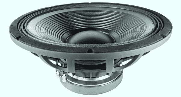

If I were going to try to build up an MHD demo, I think I know what kind of magnets I would use... :smile:
Hint...
https://media.licdn.com/dms/image/C4E12AQGjK-3y_MvCBg/article-cover_image-shrink_600_2000/0?e=1583366400&v=beta&t=8AJEXHHaeKi083uVFH7pl9G5A8un-LCf35m95pj0Q0E
