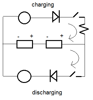

  • #31
mfb said:
Now you can only charge it but don't discharge it.
You need a diode in one direction for charging and in the other for discharging.
Hmm are you saying something like this would need to happen so the battery can give electrical energy to the motor?
Thank you for your help!
  • #32
Now the diode and the resistor just do nothing because there is a cable.
Here is a simple circuit. The thin arrows indicate the direction of current flow in the two modes. You can replace the two switches by a single three-way switch if you always want to be in charging or discharging mode.
  • #33
Yeah wow, sorry, I was so focused on that, I didn’t even realize the whole circuit would be useless, would the polarity on the motors would be the same or opposite in the picture? To perform the operation?

@mfb hello, just wondering, would there be an issue of the batteries powering the the motor immediately when the switch is closed on the both the charging and discharging sections?
Thank you!

Toeman123 said:
& yes you were completely right about the shaft
So the shaft goes from side to side and rotates? Thats a help. Strollers are made light weight, consistent with strength. The shaft will not be 'fat' and may flex when driven by a belt. It could be a good idea to arrange that the drive is connected on one side, near the shaft bearing to reduce the flexing or you could put a long sleeve around the shaft to relieve the stress from the pulley. Easy to arrange if you are prepared in advance.
Spring balances are available for 'non-Science' use. You can get them in fishing tackle shops and in many stores that sell travel goods (for checking your luggage weight allowance). You are not after good accuracy - just ease of use.
I may be over-engineering this in my mind and your design will be more of a proof of concept model, rather than aimed at production. That makes life somewhat easier as long as you don't miss out the really important bits.
