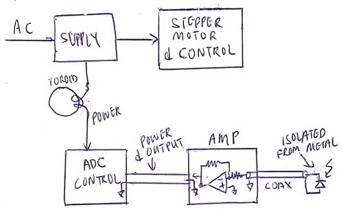

Ok, if i understood this right.
The toroid (choke?) separates the ground "domains", so that shielding on the outside is not interfering with the shielding on the amp? Don't really understand how this is working - what is noise?
We want to avoid different parts of the "ground" side of the circuit from having different potentials?
On the attempt:
I've wrapped the amp into duct tape, then into foil, grounded the whole thing to the amp's ground and added a choke at the wires going from it to the battery.
I've also wrapped most of the wire into the foil, not letting it touch any metal parts.
That's what it looks like now:
http://orbides.1gb.ru/orbf/inside_120228.jpg
Apparently, i didn't understood it well, since now i get nonsense instead of noise.
Best described as a threshold - there is less noise, but there is either nothing or a swift climb into something if light is added. Before the "shielding" it was way more gradual.
I.e. it now responds to a very, very narrow range of currents from PD with the same output it had from a much wider range before.
What have i missed?
I am trying to isolate the amp and the diode. The only ground connection is from the battery and the output line. It is important that the PD and the shield of the input cable do not tough any of the metal in the system, that if you disconnect the connector of the battery input and the output line, you measure infinite resistance from the box to the rest of the system.
Avoiding ground loop, I don't want any return current from other electronics go through the shield and the ground of the amp. I am trying to design the ground so there will be no other return path from other electronics. That's what cause the noise.
On the attempt:
If you make sure there is no contact to ground, it will do for now.
What have i missed?
I really can't answer this as I don't know your circuit. Grounding really don't change your circuit, it only give you noise if you don't do it right.
Could it be your gain is too high so either it is 0 or rail? You get rid of the noise, make sure you have all the connections, make sure the +ve input of the opamp is grounded, no open circuit. Also are you sure you want to have single supply with Vee of the opamp grounded only? I always work with dual supply.
Grounding is very involved, you can write a book just on this. You can read books in Design with EMC. That's the problem with school, all books just put ground as a triangular symbol as if you put the signal there, it will magically go away.
If you build the stepper controller with non ground plane boards, you should redo it with ground plane as bad grounding will cause more emission. Put if power bypass cap like you said one cap on those circuit improve it, do it.

  • #41
I'll try to do a simple system ground drawing later on.
First I want you to try one experiment, before doing it, I want you to double check all the connection to make sure you have good solid connections and the circuit is working.
Then with stepper motor off, double check there is no noise at the output. Use a stick to touch and move the wrapped cable from the PD to amp. If there is a lot of noise just by moving the cable. You have a secondary problem. I want you to use a stick to make sure your fingers don't create a circuit path. This kind of problem is common as the shield vibrate and induce enough noise to the amp to disturb the reading.
The usual cable we use is RG59 coax cable and just use MHV connector to hook up to the amp. So the cathode just connect to the shield and the anode connect to the center connector.
Using a coax will cut a lot of the problem of noise due to the vibration of the shield. But there still can be a problem. If RG59 is not even good enough, I would strongly suggest you to consider putting the whole amp with the PD. Or else, rigid coax with solid tube as shield would be the next, or the coax with double shield. you don't want neither one.
Try that first. If it is a problem, this is a totally different issue. At the mean time, I'll try to draw the diagram.
I saw the new picture, the ground foil looks good. On the top view, I would suggest you to bend the pin 2 of the opamp up and solder the big resistor and the 100 ohm directly onto the pin. You put the connection onto the board, you can have leakage current that ruin your reading. You might not see it now, but when you clear up all the grounding and shielding problem, it might show it's ugly head. For 1G resistor, it is not go just solder onto the board. You see articles of ground guards that you are not doing. Bent pin 2 up, and solder the two resistor onto pin 2 up in the air.
One more question, Is the PD moving by the stepper motor during operation?

This is a very simple grounding scheme, basically I want to make sure there is no ground current from other circuits going through the coax shield of the amp module. It is important the shield and the PD body is isolated from any metal of the carrier or else you form a grounding path.
150297[/ATTACH]"]
This is the most preferred way to power up the amp, through the ADC control board. if you cannot do that, a power cable with ferite toroid is absolutely necessary to break the RF ground loop.
The fact you said noise is still there even if the stepper motor is from a separate supply don't necessary mean a lot as, if you have a common ground and you are not careful on the return path, you can still have problem.

Well, the cable idea have ultimately failed.
Haven't got around to test the touch-it-with-a-stick issue.
Any coaxial cable i can get is too inflexible for the use, and wrap-tin-foil-around solution is not worth a permanent presence.
And even in a static fixture with a coax cable i got quite some noise with motor working.
Eventually i decided to call it, and mounted the amp right where the PD is.
That have effectively eliminated 99% of detectable noise, leaving only some flicker just below the lower edge of the range, and a strip of slightly noticeable one when the caret is right on top of the motor.
Good enough for me.
The idea with soldering the big resistor and the op-amp pin above the board wasn't useless as well - i get somewhat more consistent reading now, and the sensitivity got perceptibly higher.
All in all, thank you for helping.
Separate as in separate batteries, separate controller, separate laptop. No metallic link what-so-ever.
