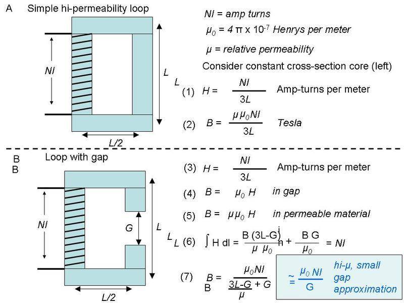

I'm making an electromagnet for a contraption. As far as I know all the electromagnets demonstrated on the web are working permanently with supply of battery (Direct current). I need to know how i could make an electromagnet which works on an AC supply with a switch ? Please provide some diagram if possible... Thanks
Electromagnets running on ac make very poor electromagnets if they have iron cores. They also make very poor inductances, unless they have laminated cores. Do you have specifics on the magnet; air gap, number of wire turns, wire gauge, resistance, required magnetic field and stability (ripple, etc.)? We may need to design or specify a dc power supply. What is the application? Please review the attached drawing and equations for a simple electromagnet geometry. See

I haven't started making the e-magnet as yet due to the fact that I want to use it with an AC supply. The purpose of the magnet upon being activated (with AC supply) is to pull an iron block over a "Seesaw" to make one side heavy (the side where the iron block is pulled). As the side becomes heavy the other side moves up to do the intended task.
I don't mind using the DC supply. But, will the magnet be strong enough to pull the iron block of about 50-75 grams.
My main purpose is to make an electromagnet which is strong and which can probably be controlled with a switch. (to work well in my contraption.)
Also it will work with an iron core as i am presuming it would make a stronger magnet.
An iron core will make the magnet much stronger, but an iron core will need a dc current, (i.e., an ac-to-dc rectifier) and maybe a filter and regulator (depending on your stability requirements). To determine the sizes of magnet to give 50 to 75 grams of pull, we need to know the air-gap separation and a little bit about your geometry. The magnetic force depends inversely on air gap..

If you have a seesaw with an iron block moving up and down, and a stationary electromagnet, then you have an air gap between the electromagnet and the iron block. The magnetic force will get stronger as the air gap gets smaller. This is positive feedback, and will lead to unstable operation.
