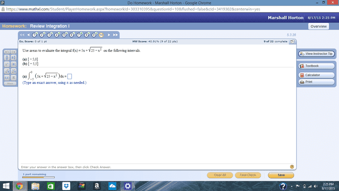

Use areas to evaluate the integral f(x)=5x+√(25-x2) on the following intervals
a) [-5,0]
b) [-5,5]
∫f(x) + g(x) = ∫f(x) + ∫g(x)
also Area of a circle = pi(r)2
[/B]
My first several attempts have centered around evaluating the integral on the first interval, from -5 to 0.
I have attempted to break it into---
∫5x + ∫√(25-x2.
After graphing y=5x, I get a point at (-5, -25) which I use to construct a triangle of base (-)5, and height (-)25.
Using the 1/2(base)(height) formula I get 125/2 square units.
The graph of the latter y=√(25-x2 appears to be the upper hemisphere of a circle of radius 5, centered around the origin.
Limiting it to the interval [-5,0] Leaves me with 1/4 of a circle radius 5, or
1/4(pi)(radius2)
To which I end up getting 25pi/4
so then I attempt to combine them with the rule of sums listed above.. My class uses an online homework system, and the answer I am entering is
(25pi/4)+125/2
That answer doesn't appear to be correct.
I had to take a year off after Calc 1, and this is my first assignment in Calc 2.. I'm trying to get back on the learning curve.Also, here is a screen shot of the actual problem in case my write up was confusing.

Could the computer be asking for a decimal answer, like 6.25 pi + 62.5?
Oh, I see now. Your triangle is negative area--You have to subtract it.
The integral
##\int_{-5}^0 5x dx = \frac52 x^2 |_{-5}^0 = \frac52 (0)^2 - \frac52 (-5)^2 = -125/2. ##
Area below the x-axis will result in a negative integral.
Keep that in mind when you add the second part of the interval on from [0,5] where both functions are positive over the interval.

It's probably easier to work with the interval [-5, 5] first.
Alright, quote function isn't wanting to work, so go with me here.
RUber. The triangle has a negative area.. That definitely makes sense now that I look at it.
So I'd be looking at something like
(25pi/4) - (125/2)?
I'm at work right now, and can't sit down and rework the problem with that prompt, so that is just the intuitive response. Thank you.
Ray Vickson- I was familiar with the fundamental theorem of integral calculus, and I do remember learning how to find anti derivatives to solve integrals.. I also remember being fairly comfortable with it.. I guess I need to go back to my Calc 1 notebook. Thank you.
SammyS- I had that thought, however the software prompts for the interval [-5,0] and requires an answer prior to prompting for the second interval. Thanks everyone for the help! I hate being behind the curve!
Marshall.Side question, is it my phone, or just how the app is made that it won't show the formulas you have entered?
(25pi/4) - (125/2)?
That should be right.
