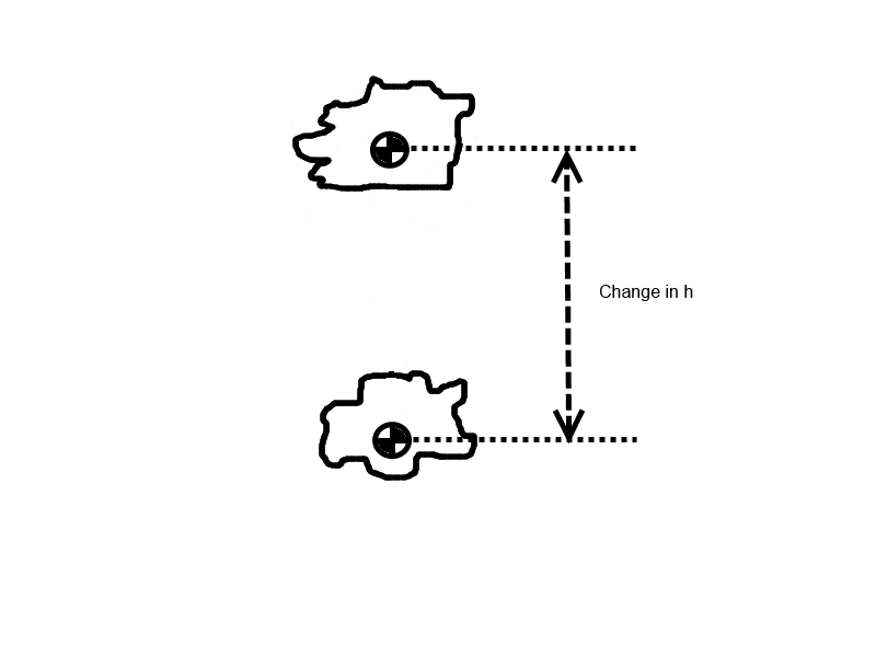

A quick question, I remember my professor said to use the center of mass for solving the classic loop de loop problem. For example, he wanted us to use the distance from the surface of the loop to the center of the object (instead of just from the loop to the surface of the block) for the height in PE = mgh. Thinking back on this, it seems pretty weird that this was done. What do you guys think?
Often the size of the object is assumed negligible compared to other distances in the problem. But when you calculate changes in the gravitational PE of an object, it makes sense to use changes in the center of mass position.

Perhaps it helps to think about the case where the object is an irregular shape or even flexible with no obvious "surface" to measure from. Something like a rain cloud...
That will certainly make things more interesting!
I, of course, was speaking of the simpler case of a rigid object (a cart, for example) with a well-defined center of mass.
With a cloud the centre of mass might be the only think you can estimate the position of.
